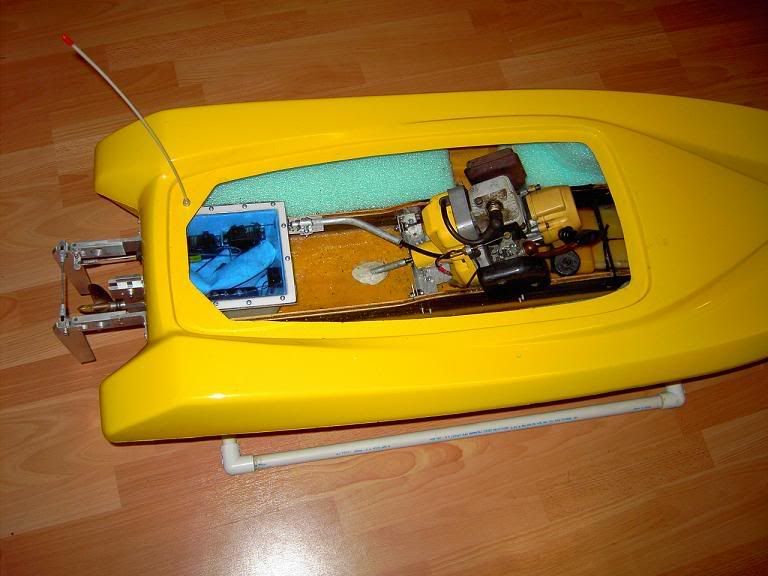

    ended up splurging at getting a real live hobby-grade boat hull. 50" long and 18" wide. fiberglass with wood transom and stringers (for prop and motor mount strength).
    the hull right when I got it:
    and with my 1:28 scale R/C nissan skyline on the top for size comparison:
    then got a 25cc McCullough weed whacker
    here it is now:

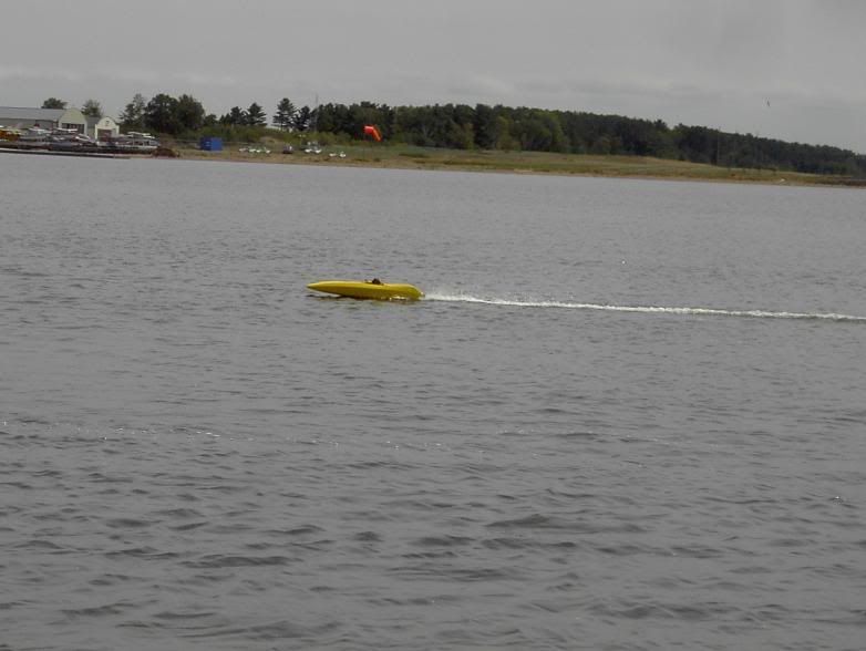

    I run it all the time off Park Point out by the seaplane base. took some pics last week:
    got a video too
    it's not running anywhere near it's potential top speed. so I just ordered a Walbro WT-167 carb for it....
    and a cheap Garmin GPS to see what speeds it's running at
    plans before next summer include a tuned exhaust pipe for more power, along with a few air scoops so I can run it with the cowl on (and keep it air cooled)

    wow that's nice - do you have an estimated top speed?

    hull: $250 shipped
    hardware (rudders, prop strut, prop): ~$150
    motor: $12 (ebay FTW!)
    radio system/waterproof box: $120
    I'd guess it's running 20-25mph now. but on the water is only reaching about 2/3s the peak rpms (if that) that it does out of the water....so I think with the larger carb, it'll go substantially faster.
    hopefully my gps will be here tomorrow so I can find out for sure. other people with virtually the same setup (larger carb and tune exhaust pipe) have seen ~40mph.
    and it fits easily in the back of the wagon....so bringing it when you guys are in town will be very easy.
    rotary weed whacker? ummm.....no. it's a one cylinder 2 stroke.
