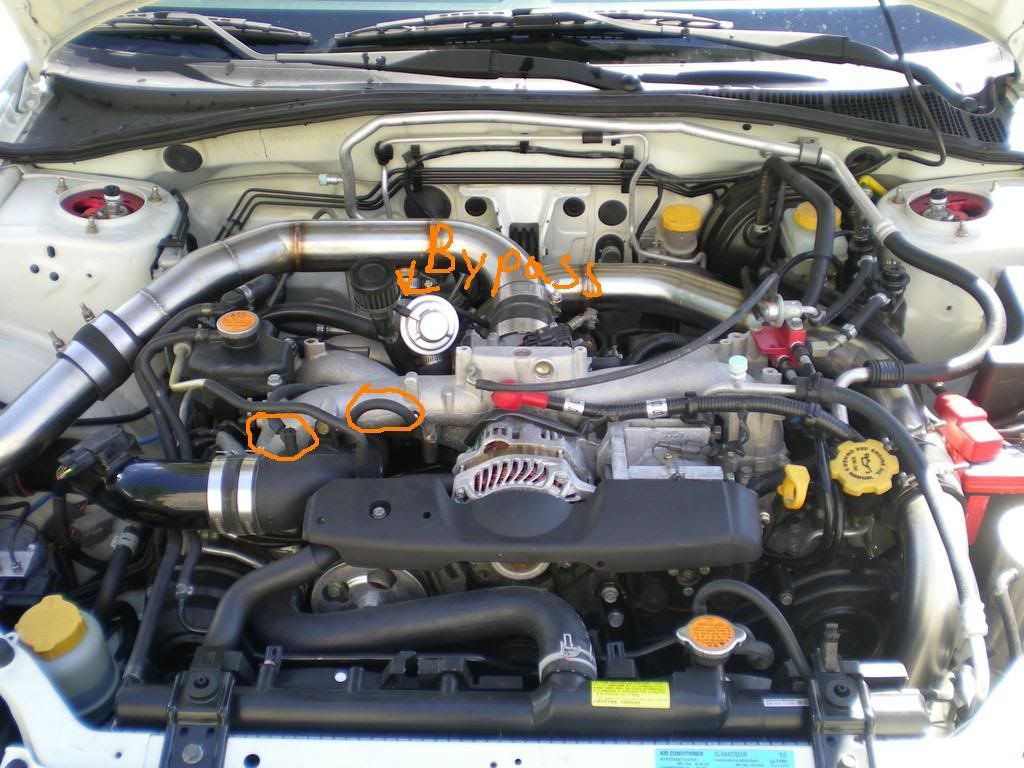

    Had some work done to my car and I cant remember where these two hoes's connected too. Any help would be greatly appreciated. Oh by the way i have a bypass blow off not a atmosphere as seen in the pic.

    on my wife's car the hose on the passenger side goes to the boost controller.
    the other one I dont know, where does it come from? there are a few hoses in that area
  3. RichWRX
    RichWRX Well-Known Member
    purge control solonoid is in the area of the center hose you have marked. If you look on the inside of your hood(drivers side) there should be a diagram of how those hoses go.

    if you can get a beter pic of the hoses I can help you beter. just need to know where the hose starts or ends and I could let you know where the other end goes. but the hose on the passenger side definatly goes to the boost controller

    ? could those two hoses connect together to form a closed loop and the one off blow off valve go to the manifold vacuum on the drivers side
  8. fayth22
    fayth22 Active Member
    yep thats what it was thanks for the help though
