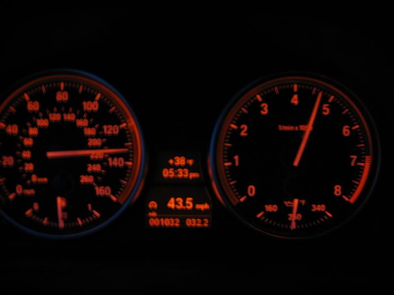

First 500 miles I take it super easy, no boost then to 1200 miles I give it a little more with some boost but keep it under 4500 rpms This has worked great for all the motors I have built in the past from Xgames rally car motors, to just normal street car motors. Now my new car on the other hand, Its still close to 4500 :laugh: NOTE!!! this picture was taken on the Autobahn in Germany, I am not that stupid to go that fast on our freeways
