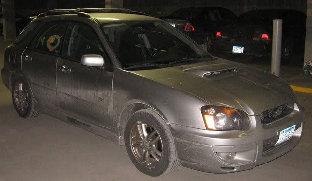

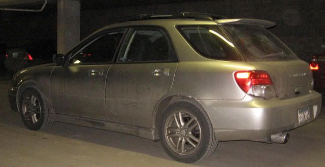

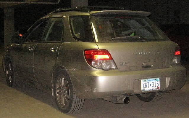

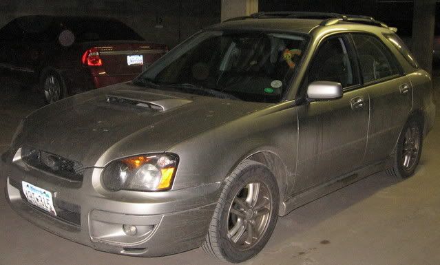

  23. 054eatwagon
    054eatwagon Well-Known Member
    304
    rosemount
    my wifes dirty......wagon
    complete with car seats and co. emission sticker
    it can only get better from here......
