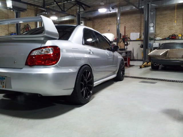

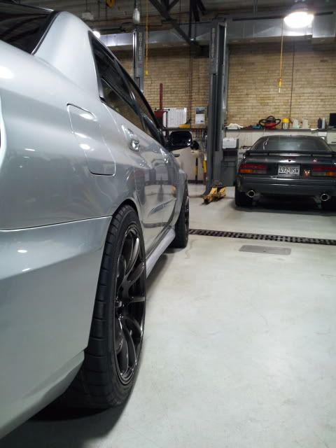

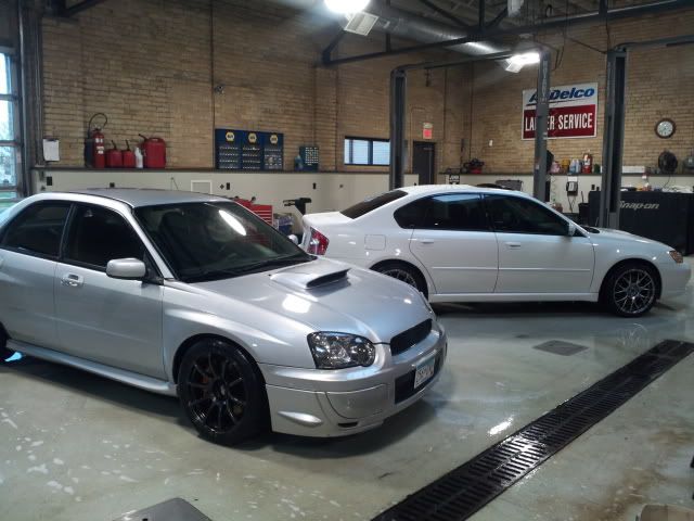

    Alright, so I picked up a set of Gunmetal 18x9 + 35 rota G-Force's w/ 255/35/18 nitto nt555's and installed them last week. I think that I like the way that they look but am still on the fence. They rub a little and will require some additional fender rolling to make them fit. I will not to with a smaller tire and refuse to adjust camber for looks (right now the car is setup on a street/track aligment -2.5* front and -1.4 rear). Before I get crazy with the fender roller let me know your thoughts and be honest. Thanks everyone!
  2. FuJi K
    not bad. i run 255's on my 17x9 +38 on my wagon. However my fenders are heavily pulled. 2.5° front and 2.0° rear

  6. 01midmetws6
    01midmetws6 Well-Known Member
    10" wheels on a GD are to wide imo, I think a 9" fits just right, these just have a little more offset than I was hoping. This wheel tire package is way easier to turn and drive than when the car had stock BBS wheels w 225 V710's. The 225's handle way better due to the compound than the 255 nitto's but having a Subi that cannot be driven in the rain is kind of pointless. The reason to not run a 17x8 is because it will negatively affect handling with a 255-275 tire. I have a set of 17x9's that will share track duty with the stock 17x7.5s. I wanted two sets of track wheels in case you have an issue with one your day is not finished.

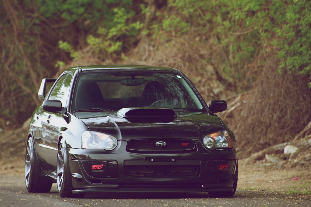

  22. Wirtz
    Wirtz Member
    It looks great. Just roll the fenders all around and you should be fine with that height. My alignment is the same as yours and I'm rocking 17x9 +30 with a tall 225/45/17 sitting low in front, and I only rolled the fronts so far but rub on hard bumps with stock rear fenders with this setup pictured

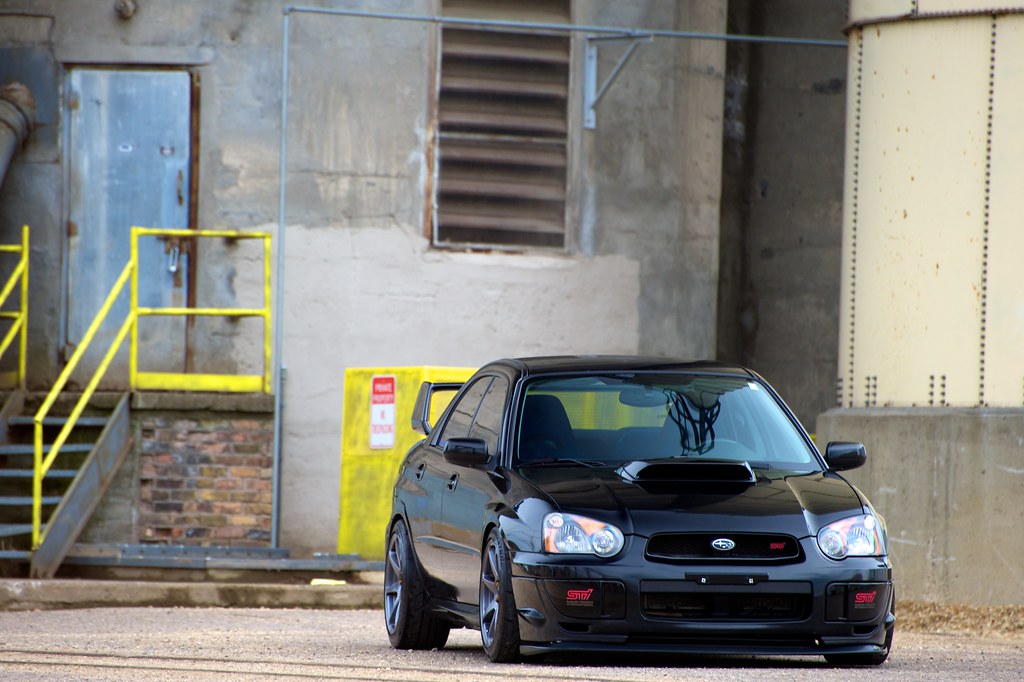

  25. TMF
    I'm normally not a hella flush type, but Wirtz's setup looks so good!
