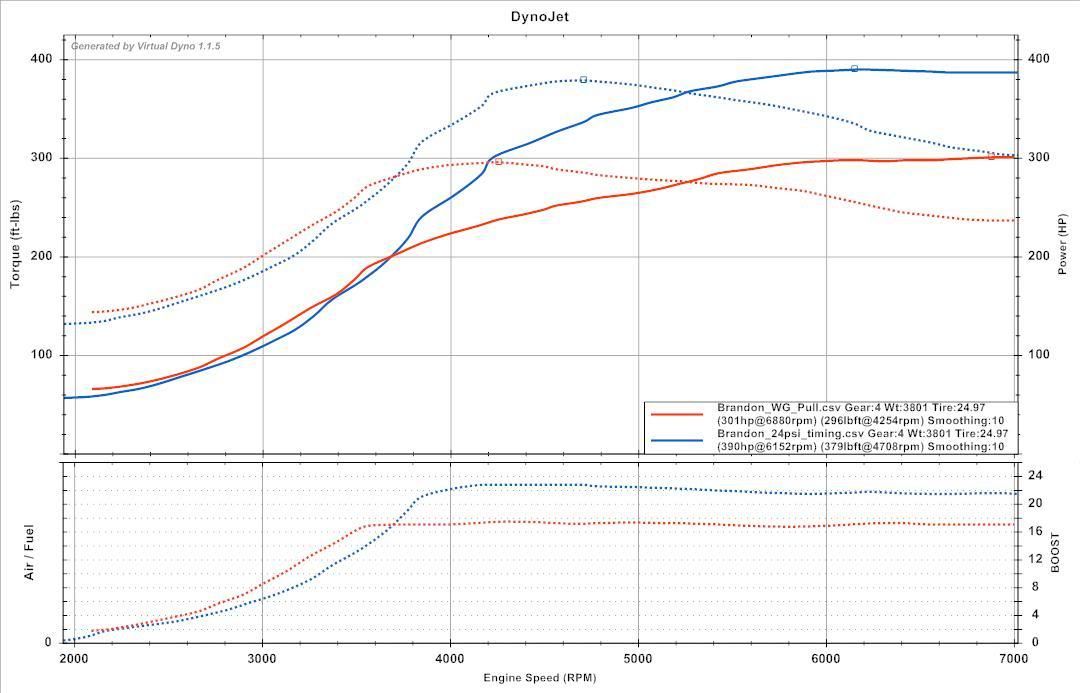

    Got this baby on the road right before halloween to get some break in miles. Then we decided to get this thing tuned before the snow falls.
    Started off with Wastegate pressure and worked our way up. And here are tonights final results.
    UPDATE:
    We decided to toss in some DW1100cc injectors (more like 1200cc) and celebrated Project Zisson's 21st birthday.
    We're boosting about 27ish psi. I know more power can be squeezed out of this setup if he had headers and cams (those head ports aren't doing any good without cams =P)
    And more boost lol
    But I feel that it's a lot of power already and I'll leave it as is for now.
    Brandon, time to get you out on the track ;)

    Curious, how much power did it make on the 20G? Dom3 should be good for an extra ~50HP, right?

    I dunno, that power graph makes me think it's a bit more powerful then what we had experienced on Dirt2 Race Day. I can see Brandon with a huge smile on his face as if he just had another new born all over again......Lucky! Congrat!

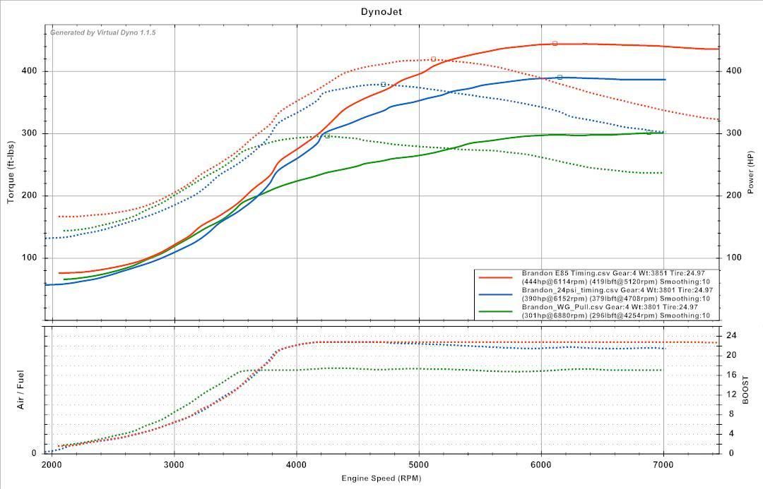

    Updated the first post with E85 results
    A few things I should note. The weight on the e85 is slightly more. This time we tuned on a full tank of gas and not with the gas light on LOL
    Second, I added a little timing here and there. I didn't want to get too crazy with it and left it moderate. When the time comes, I'll set the car to kill mode ;)

    What is the boost at now? It looks like you pegged the MAF all the way to redline, so I'm guessing the peak got bumped up a bit as well.
    Also, what are the IDC's at with those DW injectors? Gotta be getting pretty close to 100%...
  17. Nuke
    6,155
    Saint Paul
    Pegged the maf? were about high 4.8v on the aps 70mm
    Idc on 740cc were 99/100% so u can calculate on 1200
  18. xluben
    3,937
    Oops. Typo. Meant the MAP sensor. Pump gas pull dropped to around 22psi from 5k-7k, but the E85 pull was pegged all the way until redline.
    Pump and 740cc = 100% IDC
    E85 and 1200cc = ???% IDC
    I would guess they're in the 80's, but I was just curious.

    6,155
    Saint Paul
    Should be around the 80's
