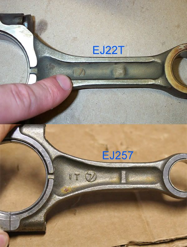

    xephyr, or say Mark...has ran a good amount of boost in his EJ22T(dude from Colorado). A guy near sea level ran 27+ psi later bent a rod. But of course that is SERIOUS BOOST though. I'm sure they're making a good HP number.
    Well...I found some pics of the EJ22T rods. And a quick snap at the EJ257 rods. I dunno..which ones look better?
  6. readymix
    The EJ22T ones look a little beefier near the crank side. As well as the small side. But it also depends on forging and metallurgy. I'd pretty much bet that a new set of Rods is more of a security investment than just keeping these and hoping for the best.

    IMO the ej22t one looks better. notice how the edges appear to be thicker. also notice how when it gets close to the crank/piston it slopes up to it and isnt just a sharp angle. kind of hard to explain but it just looks more hard core.
