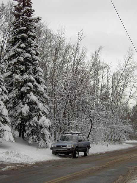

  4. 95lwrx
    95lwrx Well-Known Member
    here's my 88GL with BYB 3'' lift and 29" tires, and yes the dual range 4wd is awesome, 4lo is sweet :lol:

  6. krees23
    krees23 Well-Known Member
    Do you have a front shot of your front bumper / light bar setup? From the side shot it looks really good, I'd like to see more of it.

    and a couple pics of my '88 (details in sig)
