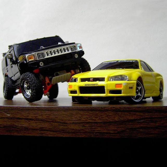

I'm very happy with my skyline performance wise. it could be faster, but I rarely run it wide open anyway, I just don't have the space. The hummer, on the other hand, is getting alot better, but just doesn't have the torque to pull over much. but I've ordered a ball bearing case and really strong magnets to help with that.
