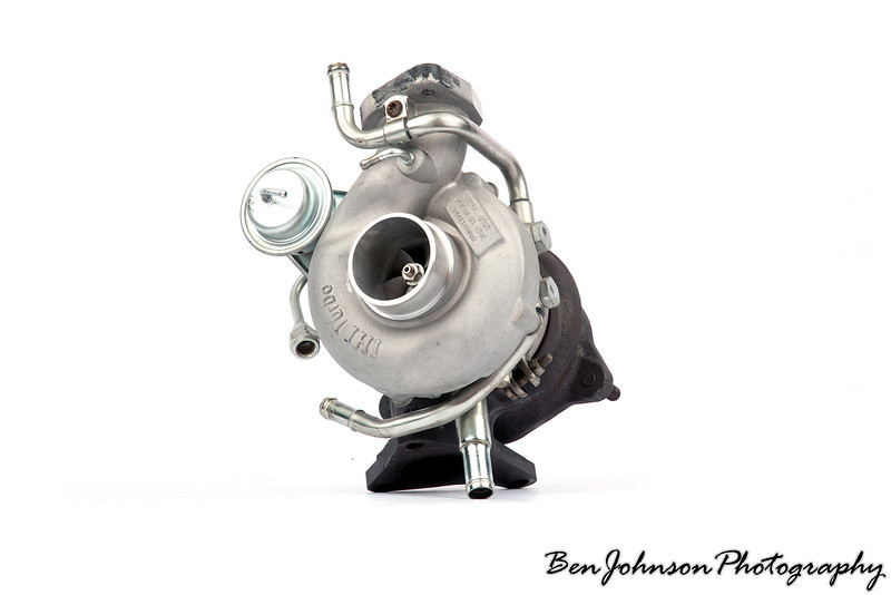

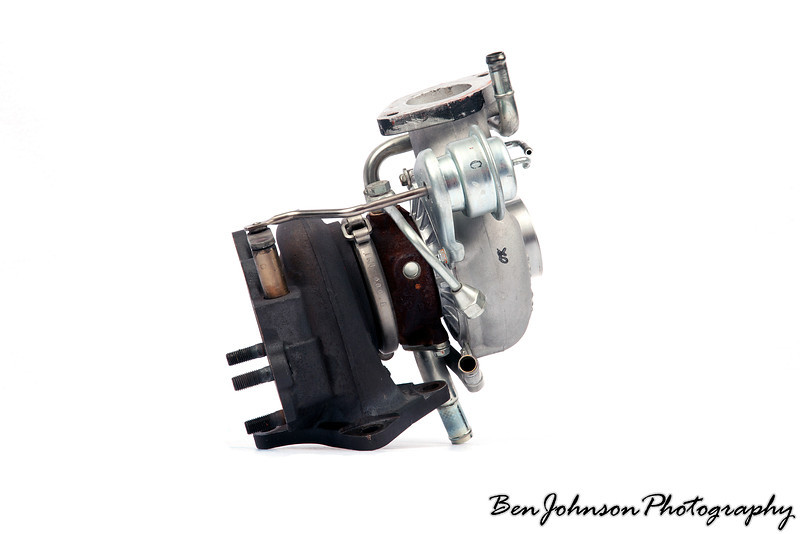

  28. xluben
    Derek's turbo. Looking fresh!
    ofspunk7 and BroCo like this.
  29. ofspunk7

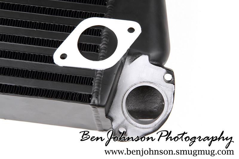

    Looks great Ben. Thanks for the photos.... it's so clean. Did you do that or was it the work of NF?
    Edit... just noticed some residue from my gasket maker. I need to pick up a GS gasket when I put this all back together. The IPR TMIC one that I have sucks balls.
  30. xluben
    I cleaned it. I removed as much of the gasket maker as I could. The sealing surface is flat, but there is still some silicone visible.
    GrimmSpeed doesn't make that gasket yet. Hopefully their 08+ TMIC gaskets come out soon because I'm sure a lot of people could use them!
  31. ofspunk7
    Damn. I have to go over there for an exhaust gasket tomorrow. I was hoping they would have a turbo one too. Any idea on who carries a good replacement? I dont like what i have.
  32. Mr.Tran
    Mr.Tran Well-Known Member
    286
  33. ofspunk7
    Maybe. What came with my TMIC sucks.
  34. xluben
    The OEM TMIC seal is an o-ring type gasket. It allows for a reasonable amount of "squeeze" and usually creates a good seal.
    The IPR TMIC has an o-ring gland, but I do not believe it actually comes with an o-ring. Only a flat, hard plastic "gasket" or spacer.
    The spacer is not likely to seal well, and I believe Derek found this out, and that's why he used silicone.
    Instead of using the spacer you could buy an o-ring to fit the gland (the OEM one will not so you'd just have to go the hardware store and see what fits), but I don't know how well it will seal, because it will be an o-ring with a relatively small cross section (due to the dimensions of the gland). If you go that route, then don't use the spacer, unless you're still going to do silicone on the bottom of the spacer.
    Honestly the silicone may be the best option. I tried the gasket/spacer, and nothing else, and it didn't seal well. Then I went to just the o-ring and it did seem to work OK, but it wasn't perfect. The silicone is a mess (especially if you have to take it on and off a lot), but it should do the job pretty well. The other option (that I didn't try) is to cut a custom gasket yourself. Just find some gasket material from the auto parts store and trace out your pattern and cut.
