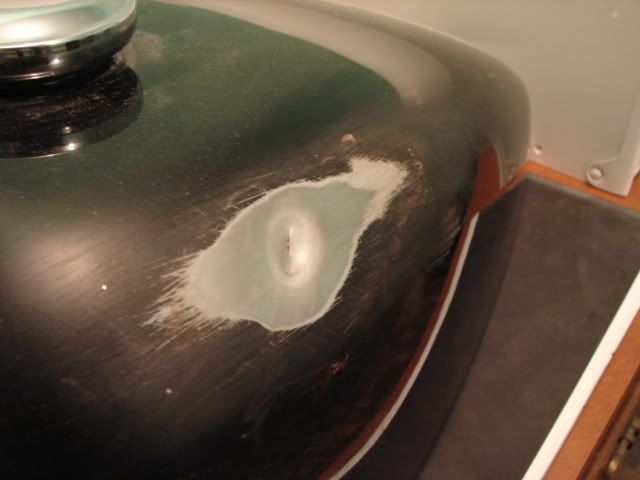

  19. Skarecrow
    Skarecrow Well-Known Member
    when it comes to paint.. I like to think I know what i'm talking about...
    example
    top picture.... = graphic done correctly..
    bottom is an example of random scratches showing through 2 layers of primer, and plain coat.
    ((took a complete strip down, and build up to fix..))

  21. curly2k3
    those motorcycle tanks needed more body and prep work :p

    ((tell me about it... that tank was horrible... was a damaged tank supposed to be a cover test to see how the AA colors covered deep scratching.. they do a freaken dang good job.. but the truth of the matter is.. nothing covers scratching like solid prep work / primer))
