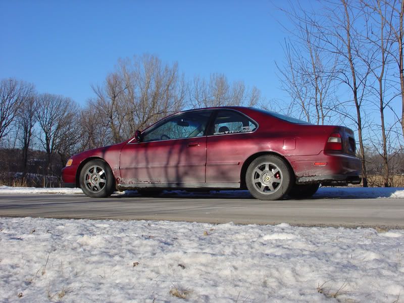

    my old accord with the winter rims (painted stockers)
    my STi with winter rims (painted bronze)
    i have not had any chipping problems with self painted wheels. do it right and they are very durable (clean them thoroughly, scuff entire wheel, lay down primer, paint, clear)
