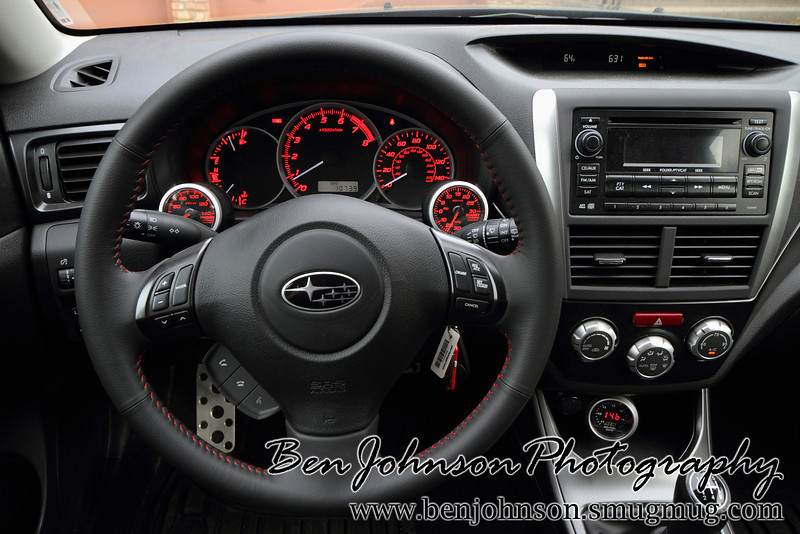

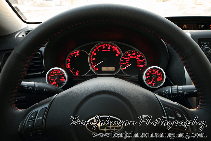

These are the 3 that I have. I have the SMY Cluster with the boost and oil pressure gauges in it. I have the wideband in the center cubby. I chose these locations because I didn't want anything that would be easily visible from outside the car (ie. on the dash, in the clock, or on the A pillar). Those locations may be a bit easier to see, but I wanted to keep the clean look. Here is a better angle of the what the cluster gauges look like from the driver's seat. The gauge on the left is partially blocked by the blinker lever, and that gauge very slightly blocks the OEM coolant temp gauge. Overall the visibility is good (it is the best possible with the amount of room available), and the quality of the SMY cluster is excellent.
^ Ben forgot to mention that the SYM Clustermaker cuts off part of your gauge on the left side. I believe the turn signal is in the way. Also the gauge cuts off part of your temp on the OEM cluster.... it is hard to tell from the pictures above... but that is why I did not get the same setup.
I had nothing but issues with the a-pillar pod and rallyx. Always hit the knuckles on it when heavy sideways steering was underway. I like Bens set up with them by the oem cluster. Out of the way and i can't imagine that they really obscure the other guages that much. As far as guages go, look into ProSport Premium guages. Modern Automotive Performance carries them. Can't beat the quality to price ratio! Boost guage,water temp,oil temp were my first pick...my engine fluid temps concern me more than anything else.

Haha, no worries. The actual gauge blockage from my viewpoint while driving is somewhere between the two photos I posted. A decent chunk of the gauge on the left side will be blocked by the blinker arm, but very little of the OEM coolant temp gauge is blocked. The amount of blockage will change based on seat position, seat height, driver height, and wheel position. I have my car set up to be comfortable to drive, and that's just how much of the gauge is blocked. You could surely set it up to block less, but it might not be good for driving (depending on your size).
