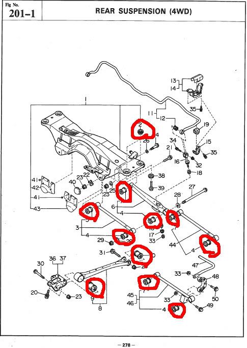

  10. EtchyLives
    EtchyLives Well-Known Member
    This is what I'm up to.
    Threshld1, since you have experience in doing this I'm going to cordially invite you to help me. I will offer an exterior detailing of your car and beer for your help.

  13. Chin
    Chin Well-Known Member
    Been there....done that. Enjoy! AAARRRGGGGHHH
    (I hope you have a 'fund' set aside for the replacement bolts you are about to buy) ;)

  15. EtchyLives
    Bolts on order. You weren't kidding about the 'fund'.
