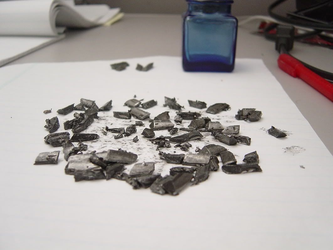

  33. esperunit
    esperunit Well-Known Member
    3,067
    Paris, 7eme Arrt.
    lets just say that your first gear couldnt have been worse than this:
    and your clunky shifting will pass as it breaks in. I have an 02 gearset in my yellow car and afet 1k miles on the tranny i put redline 75w90 gear oil in it and all teh shifter slop vanished. I'd break it in with normal ear oil though.
  34. JeWrX
    JeWrX Well-Known Member
    Woodbury
    Hahaha, no not quite that bad, just two teeth snapped right off, but no...not as bad as that !!!
