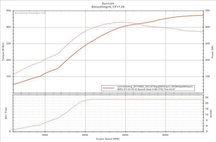

One of my favorite turboz!!! GT3076r .82 and tha booooooz Still a bit left but I think it's good enough for now. (Juks, enjoy the car) Enjoy Want your car fast? Holla!
Thanks for all the help Nuke, it runs great! Like stock until WOT Peak boost is around 26.5 psi in 4th. Hit 27.4 in 5th this morning. Accidentally hit 28.8 yesterday but it took it :eek4: Not to mention a blown fuel pump fuze in the middle of a long ass bridge... Tuned by Nuke, built by Vandde, installed by Matt @ RS, bolt ons & suspension by me. It's been a long expensive journey to get this thing running, feels great to be back above the 400whp mark! Haha hey that'd be fun, we'll have to meet up sometime. Maybe Brainerd this month? I have to get my tranny rebuilt before I can hit the track, no reverse I could prolly do a 1/4 mile still. I'll get some pics of the car up when I get home Monday.
Can we get a brief mod list? Powerband looks very strong and use-able. I would like to meet this car. Nice works guys!
1260cc injector Perrin FMIC (or is it APS, I forget) + Blow thru MAF Stock heads Forged piston Stock headers EWG + 3076r E85 Nuke's Blessing Very similar to yours Matt And his name is Matt too =O
Perrin FMIC KS Tech 86mm blow thu MAF w/treadstone performance honeycomb air straightener CP 99.75mm pistons/eagle rods built by Vannde Perrin equal length headers (wrapped) Perrin 3076 .82 rotated kit Tial 50mm BOV (7psi spring) Perrin stealth TBE PnP IM, TB, TGVs (w/deletes) DW 301 FP w/Boost a pump Aeromotive FPR UR 1260cc injectors Perrin V2 rails Crawford A/O separator Stock ECU/COBB AP tuned by Nuke (E85 FTW!) High speed conversion 6MT gear box w/PPG billet selector forks (built by mystery rally mechanic) ACT Heavy duty 6 puck clutch ACT Streetlite flywheel Lightweight crank pulley Engine/tranny mounts BC Racing BR coilovers BC Camber plates F/R Whiteline 27mm swaybars F/R Kartboy endlinks F/R Whiteline ALK Polyurethane rear diff bushings/rear subframe lockdown bolts Dunlop direzza star spec tires on stock BBS rims Powerslot rotors Stainless braided brake lines KS Tech hood scoop delete Seibon wingless trunk Blacked out tint, headlights, tailights (2 warnings on tint/covers, 1 citation for no MN registration )

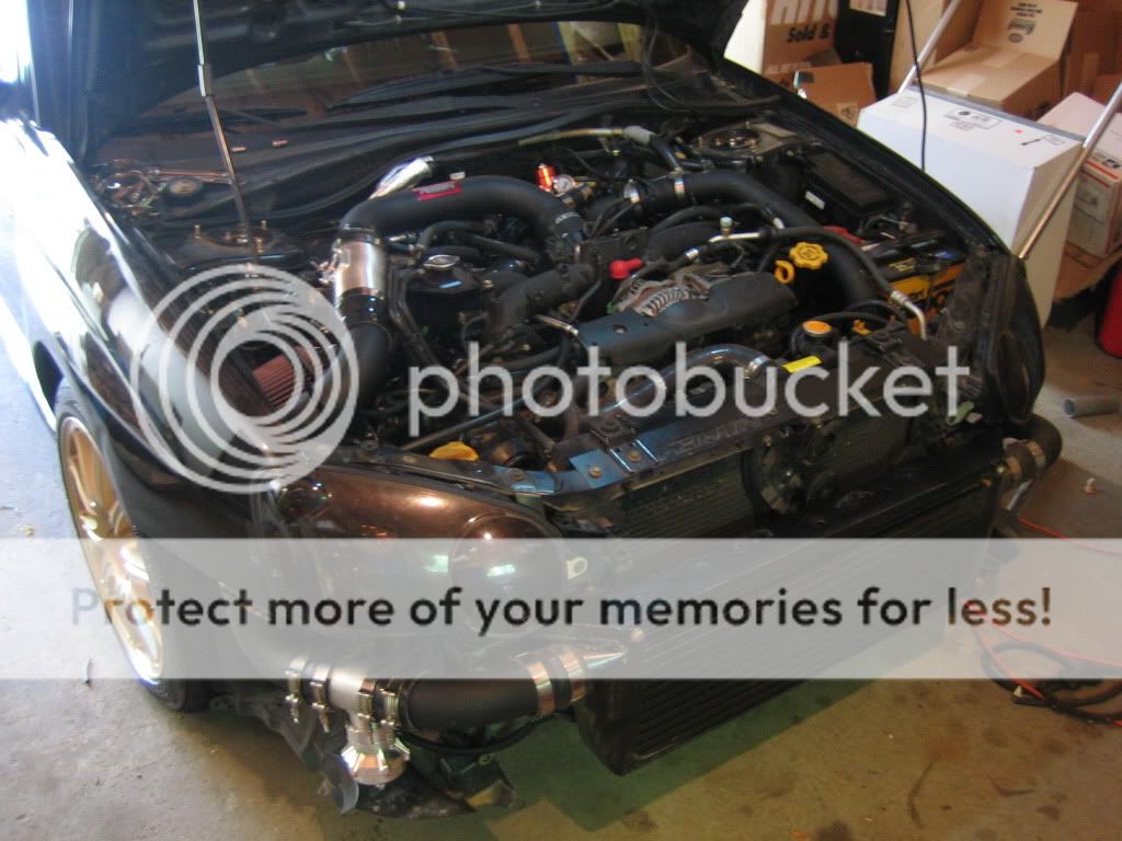

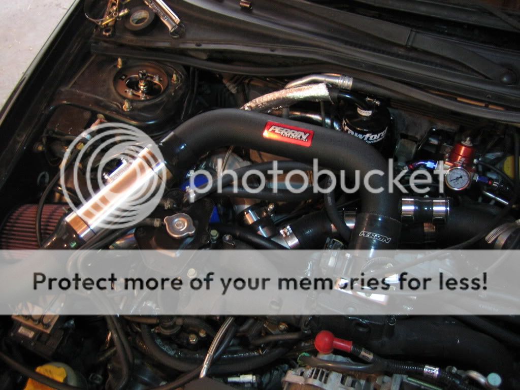

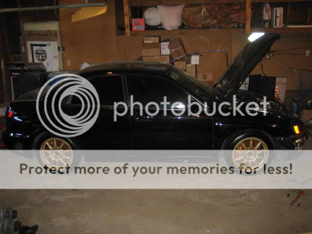

Couple pics Here ya go, nothin too fancy! I have to admit I don't put much effort into trying to make things pretty
