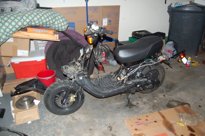

    So instead of buying an 800 dollar head unit I bought an 800 dollar scooter!
    Got it as an non running machine pretty much. The guy that sold it to me thought the scoot was shot and had something wrong with the wiring because it would not start. Well, it took me 15 minutes to figure out the problem and be on my way home with a little toy. The problem was that the gunk in the carb would not let the bike suck in the fuel. I opened up the drain valve and in 5 minutes the thing was running like new.
    The Zuma has only 2k on it and is a 01 model.

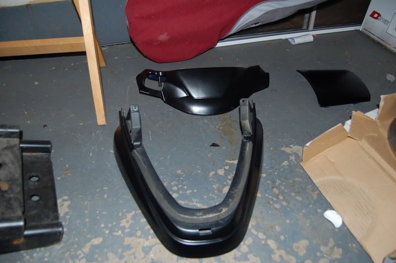

    So far I have cleaned the carb on it and tuned it a little better. Changed all the fluids( there was noting in the transmission) and started on the paint.
    So here is my plan for this little toy.
    Ordered a stage 2 performance kit for it. Which includes a: Tuned pipe, bigger carb, 70cc cylinder and piston, new vatiator, straight cut gears and some other misc stuff.
    With all the upgrades it will hopefully top out at 55-60 with all the right tuning. And the acceleration should be no worse than a subbie has.;)

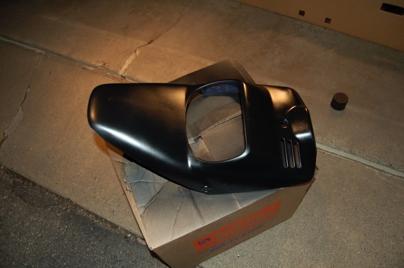

    The paint will be flat black hence the name “stealth fighter”

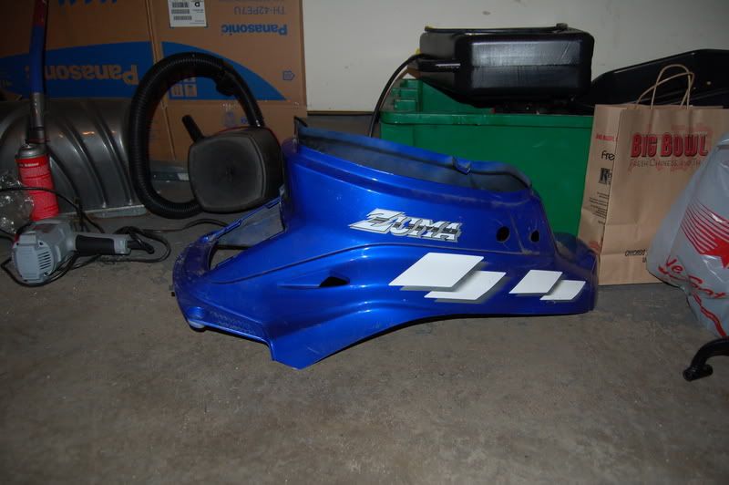

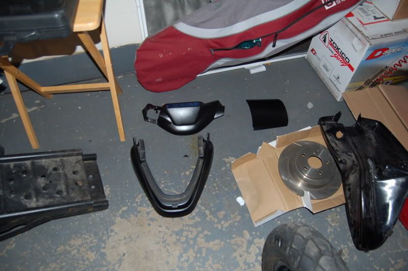

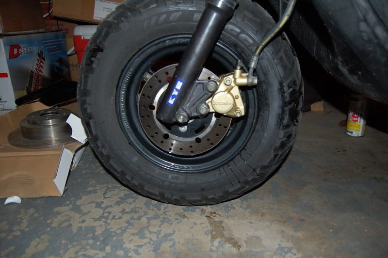

    Here are a few pics.
    Brembos and KYB shocks FTW!

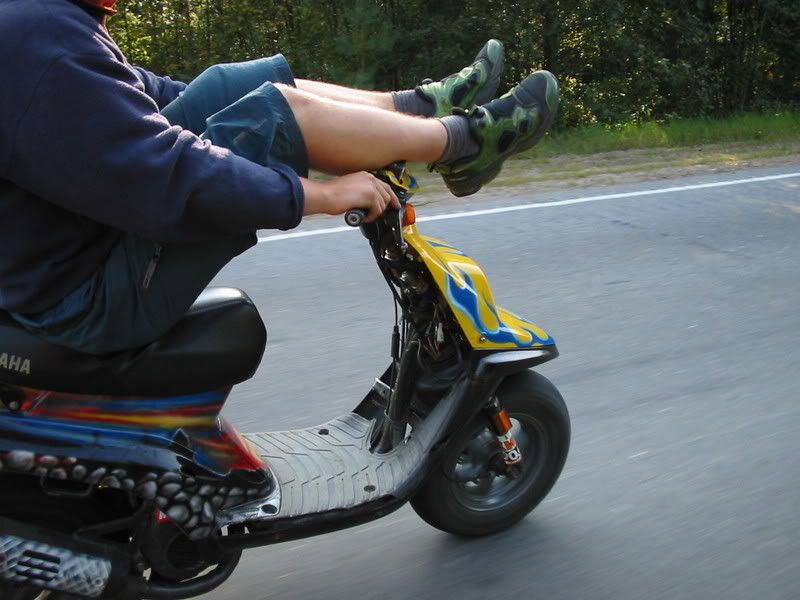

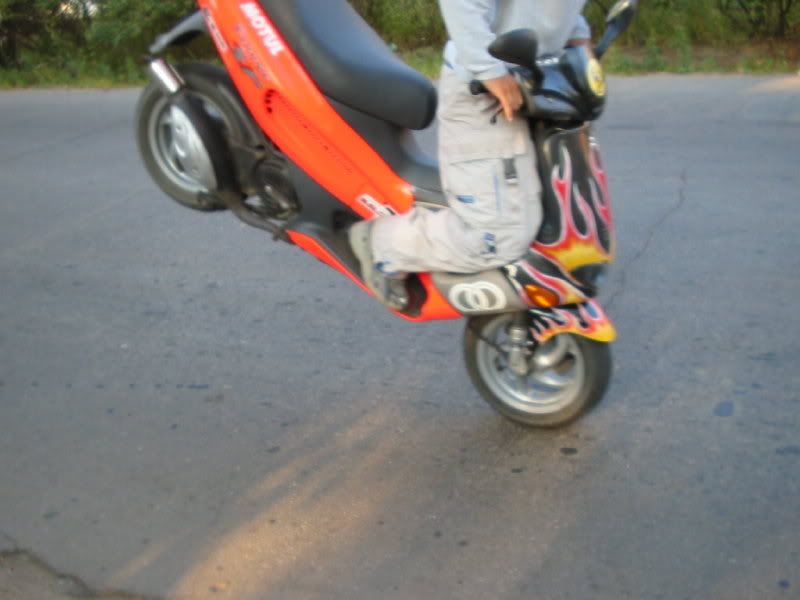

    wow, i can not believe i found these pics. they are from when i was like 14-15
  17. Taras
    Taras BANNED
    217
    Saint Paul, Minnesota
    that is me on the first two pics and the video
    was wondering if covering flat black with clear coat will make it glossy?
