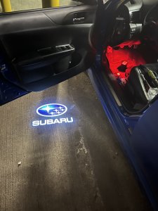

    Have been wanting these for a while now, in an attempt to "modernize" my 2011 Sti.

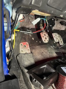

    Theory was to connect the puddle lights to the footwell lights as they turn on when you unlock the car.
    There is unfortunately no constant power in the door, and the door open/close switch is mounted to the interior B-pillar so wiring that way would be a mess.

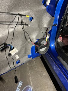

    Either way you need to pull wire through the grommet in the door, which is a huge pain, but the fiberglass rod puller helps a ton with that.
    I pulled power and ground from the footwell lights to keep everything on the same circuit as some of the ground circuits in the door are switched depending on what buttons you're pushing and the fact that Subaru is classically ground switched signals.
    -Started by removing the kick plates and accessing the tunnel to the door grommet.
    -you can remove the door cards at this point too. four screws and a bunch of pull pins.
    careful pulling up the control switch part as it can scratch the door card. and/or you can break the rear pull tab. pull up mostly straight.
    -Measured the wiring and connected all the interior wire connectors without connecting to the footwell light. did that last as I didn't disconnect the battery (because I'm so wild)
    -pulled the wire through the door with the sheath on
    -attached the quick connect on the door side and cleaned it all up

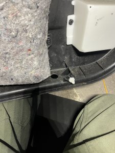

    -drilled the hole for the light closest to where the door closes just in case it stays on and you can see it when you're in the seat, I didn't want it to be a distraction. the door seals there, so you can't see it from inside, so no need to take that precaution.

    -then attacked the footwell light (there's not much wire here so using extra wire would be really smart, I did that on the passenger side to give some breathing room.)
    -finished by connecting all the quick connects
    -reinstall door cards and tweeters and kick panel plate
    -reconnect the grommet for the door (biggest pain of the whole project)

    Wow, those are pretty bright and clear(easy to read)!
  3. Superglue
    Superglue Well-Known Member
    108
    42
    yeah, there's a bunch that I've seen that are really stupid or kind of blurry. I splurged and spent ~55$ on these instead of the other "Chinese brand" for 30$ because that crisp is really nice.
