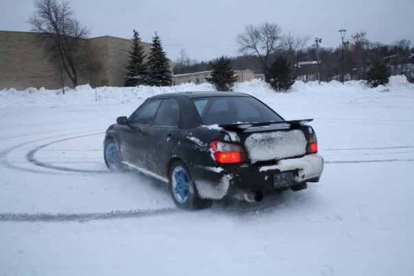

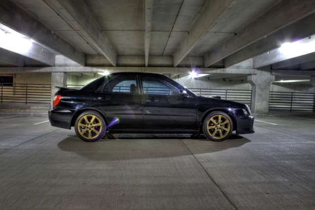

    Anyways, some of you may remember my old 2002 MBP WRX that was sold last winter.
    Boy do I miss that car. It was my first Subaru and by far has been my favorite. So, the WRX was sold to put some money towards a house in the upcoming future.

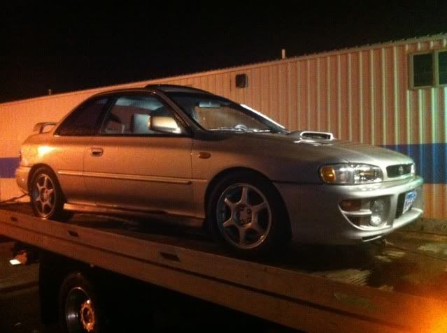

    This left me in a car-less postion. But just two days after the sale of my car it was like a gift from the heavens when I got a call from a fellow member on here that an RS has shown up at their shop and it looked like the motor had gone. After getting some more background information on the vehicle, we determined that it was actually an old High School buddy of mines older sisters car. Yay, I knew the background of the car and know it was "well" taken care of. Sight unseen, I told him I wanted it and let me know what it was going to cost.
    The first sighting!
    So, after two days of negotiating and polotics, the RS was mine :)
    I turned the car over and on the first crank it started! Then we gave it some revs and it sounded like there was a whole mess of nuts of and bolts somewhere in the engine. After a min of idle, there was enough smoke in the air to concern the EPA. So, we killed the car and loaded it on the truck to be brought back to my house for a new heart.

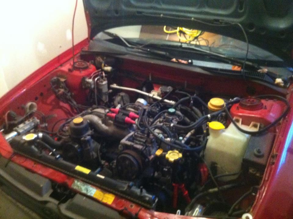

    Once the car was unloaded it was parked for a couple days and then the real fun started.

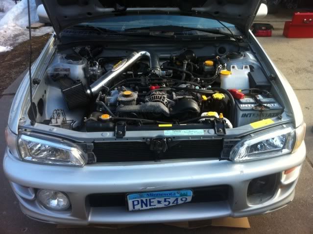

    We popped the hood and, well, I'll let the pictures explain the next bit....
    YIKES!!!
    Okay, well, not to worry. We pulled the motor and the race was on...
    So, this would have been the best time to do a fun ej something turbo swap, but I had to keep telling myself that the purpose of this car was to just be practical and money conscious. The hunt was on to find a replacement motor. Sure enough, I had one sourced out... in Chicago... But, I couldn't pass up a descent deal and that was the best bet on the market at that time. 800 miles later I was back in Duluth and ready to get this thing squared away.
    (video for the lulz)
    All right, first try and she was ready to go. There was a period of about 25 min that she just burnt all of the old oil out of the exhaust pipe.

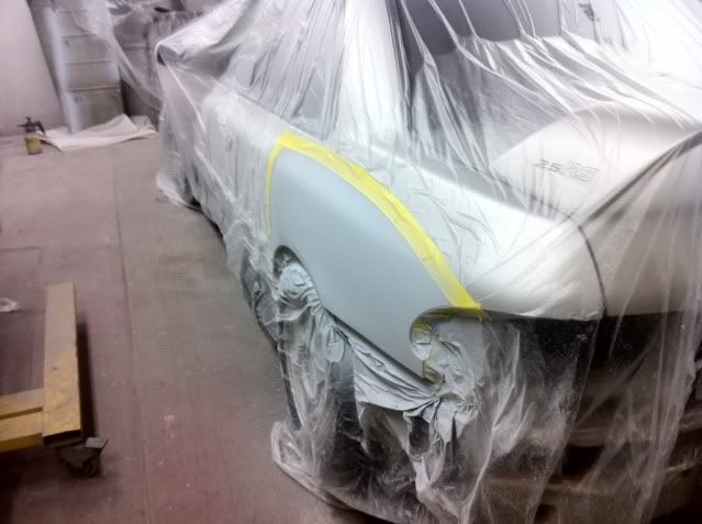

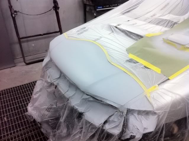

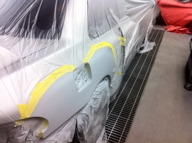

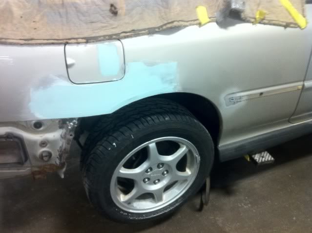

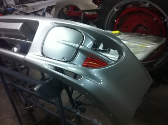

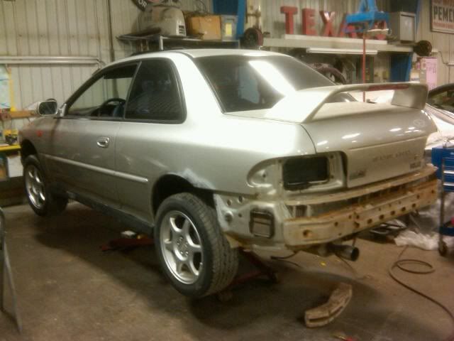

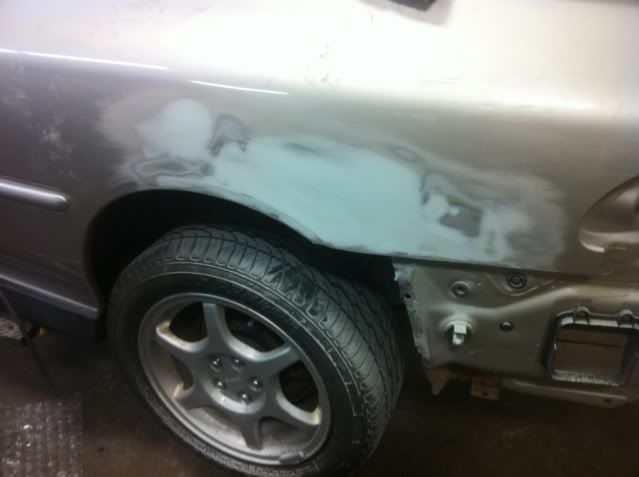

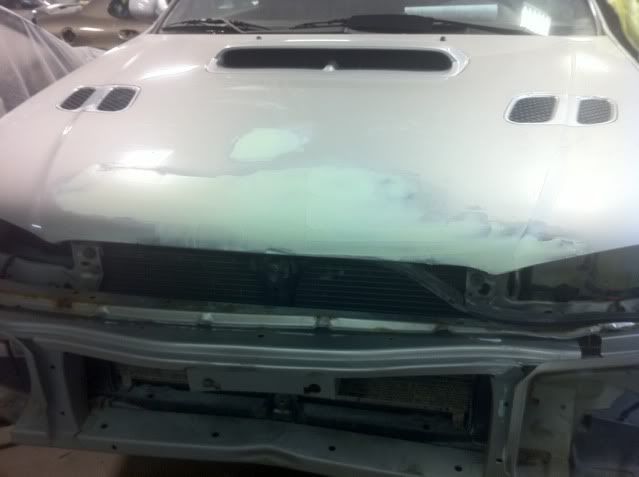

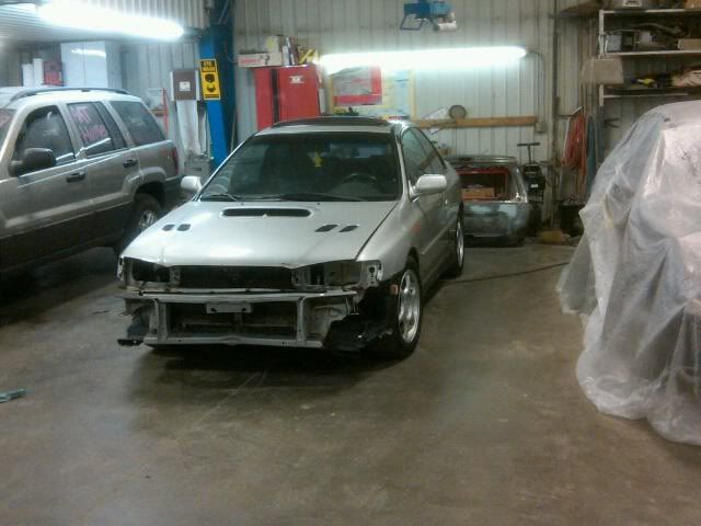

    Next day, time to take care of that rear quarter panel rust, install new front bumper, and get it misc things painted.

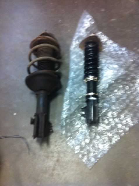

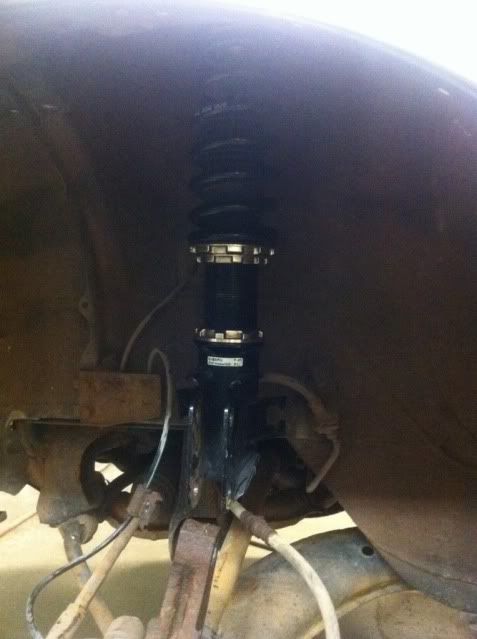

    As the body work was taking place during the day, I decided that since one of the struts was blown it was time for a suspension upgrade ;)
    Alight, back to the body work...
    Tada, she is done!
    (for now)

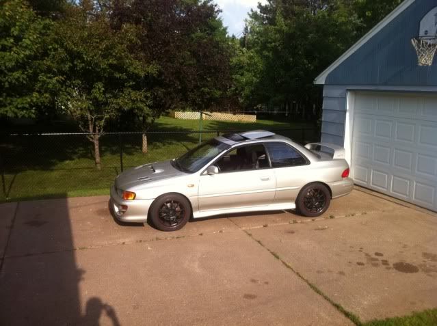

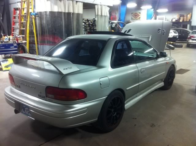

    Okay, that was quick.. As you can see, I picked up some summer wheels, painted the side skirts and still had to install my front lip. Well, I did all of that and here is the progress and where the car sits today (9-5-11)
    Thats all for now...

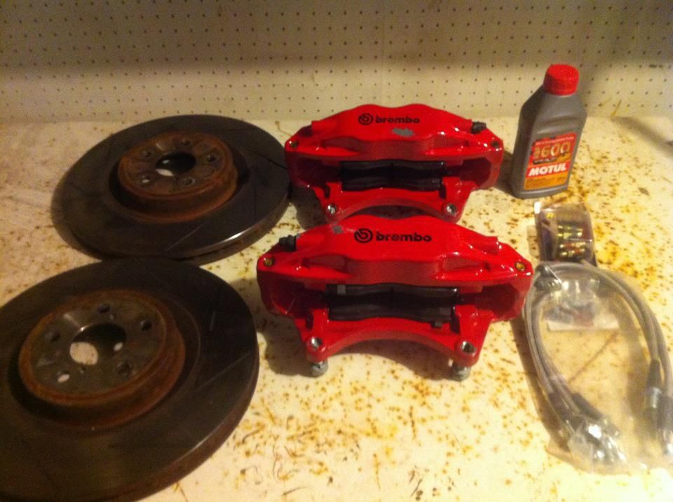

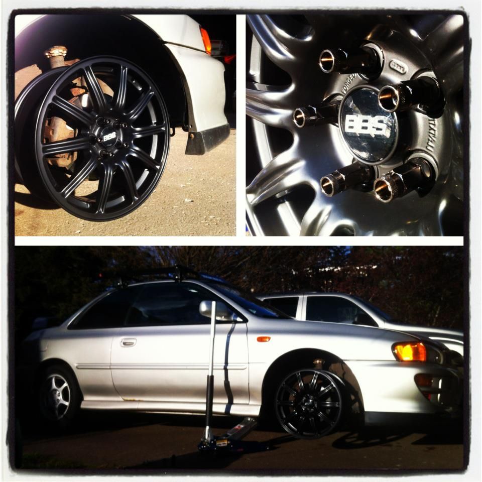

    At some point in this adventure I bought some Brembos off of an 04 sti..
    But I sold them and went with the ever popular (and able to fit under 6spokes) 06/07 4/2 pot brakes..
    Oh, and I had bought some 04 bbs wheels.. Had them powder coated, and then sold them.. :(
    Somewhere in here I spent way more money than I had ever spent before and did the "House' Mod"

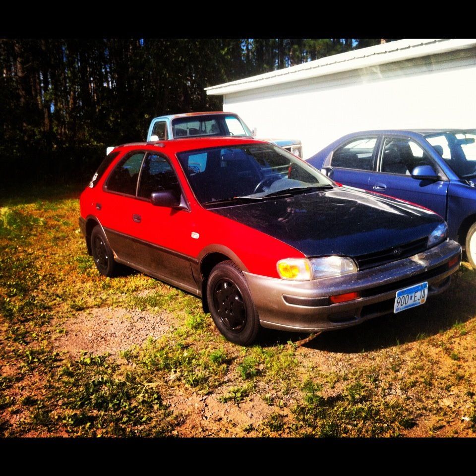

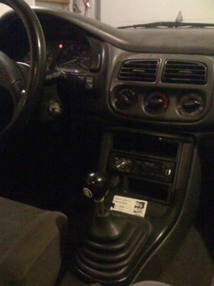

    I saw this hit craigslist and it was love at first sight.. I needed to have this thing. (Some of you may know this car as "baby cakes" in a previous life..)
    You had me at accordion shift boot... ;)
    Anyways, I picked up this trust 96 obs with under 200k miles on it for a really decent price. (about the cost of real GC8 tail lights which the car had/hass on it)
    Only real issue was, well, "she just stopped running one day" and they PO didnt want to fix it.. How bad could it be, right?
    Fast forward from August to November and this thing had been sitting in my driveway just bringing my property value down.. It was decided that it is time to get this gal up and running.
    I knew going into this that the car was involved in an accident a few years prior. Fondune on here smoked a deer and gave the car up.. Upon it's transfer of ownership(s)? it has seen some extremely custom work to the engine.. Including the one of a kind License Plate Timing Cover...

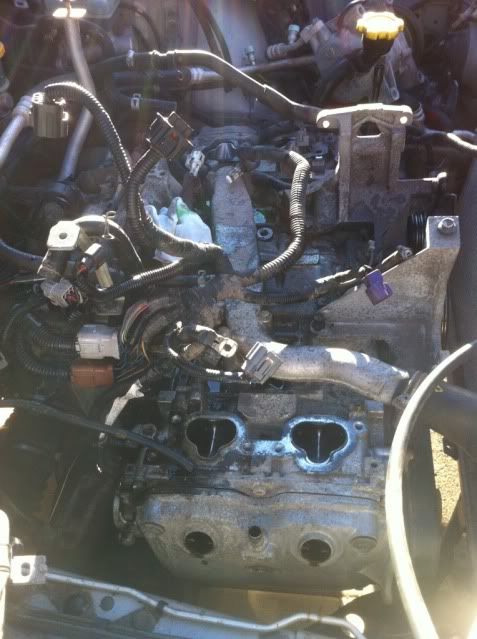

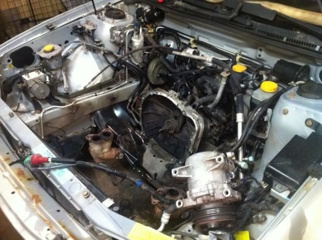

    Looking past some of these "minor" details, we pulled er into the garage to being the disablement of the motor.
    Once everything was pretty much free (minus the trans and motor mounts) I commissioned a friend with a trailer and a winch to help me haul it down to his shop.
    Got it up on a lift and began to pull the motor out..

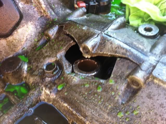

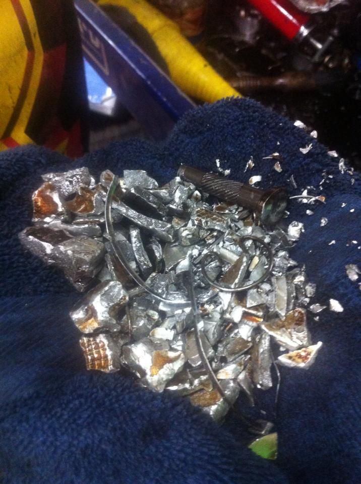

  25. Ctracey218

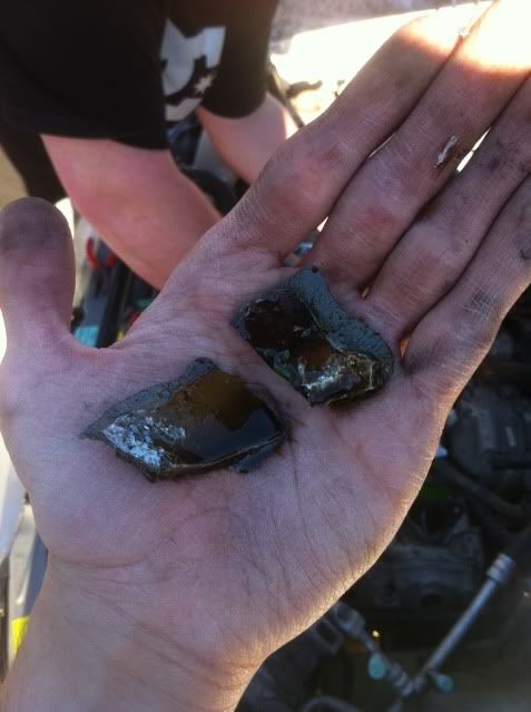

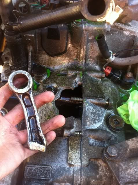

    Now that the motor was free, we decided to do some digging into exactly what caused it to stop running... Dropped the oil pan and removed the heads..
    I will let the pictures speak for themselves...
    As you can see, total carnage had occurred...
    Long story short, replaced the clutch since she had nothing left to give and we put a new-er-ish slightly used 2.2 back in and she ran like a top.. (minus the missing ground wire that allowed the car to stay running when I pulled the key out)
    We fixed that, put the new exhaust headers on it (for the price of one 24pk THANKS IZZY) and away she went.

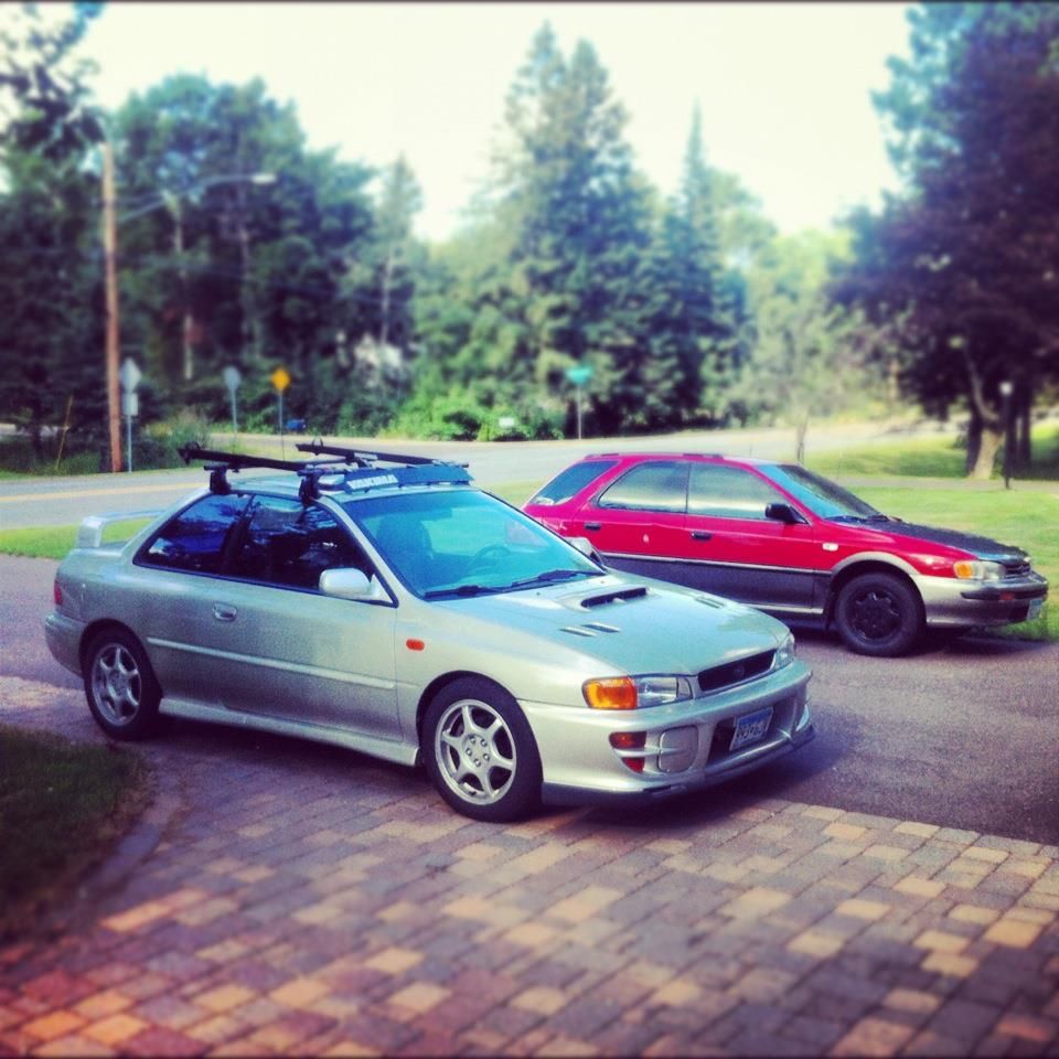

    One happy family
    Now to get the beater registered and start tearing down the rs :)

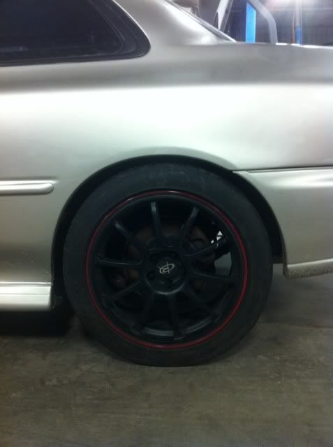

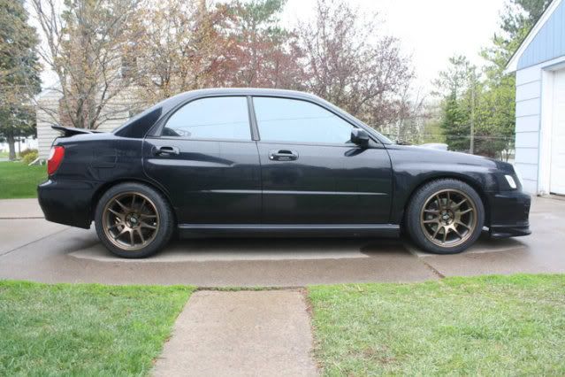

    These are rota torques correct? Do you know specific sizing? Also, what suspension was under this car?
  41. Ctracey218
    Wheels:
    17x9 Rota Torque -Full Royal Sports Bronze (5x100/e30/56.1)
    Tires:
    Nexen N3000 (cant remember specificly.. but maybe 235/45/17?)
    Coils:
    K-Sport Kontrol
    Front Spring Rate:9/504
    Rear Spring Rate:5/280
    36 way adjustable
  42. 01midmetws6
    01midmetws6 Well-Known Member
    How did they fit, that is an aggressive offset and width. I was going to test fit my 17x9 +42 grids but I don't think they will even come close. How much camber and fender work did you have to do?
  43. Ctracey218
    Lots of trial and error in the rear.
    Rolled the fenders/adjusted coils to FIRMEST/camber bolts to correct the last bit.
    Fronts were pretty straight forward and didnt have any rubbing..
