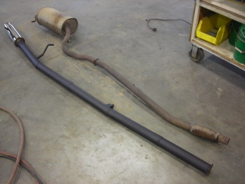

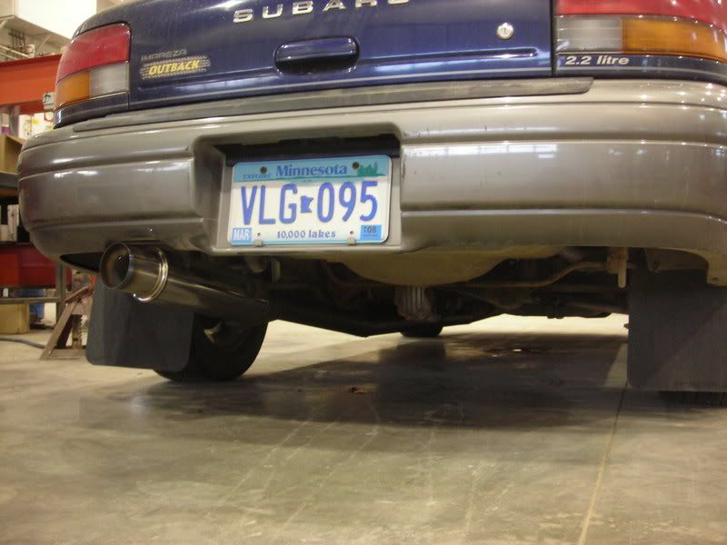

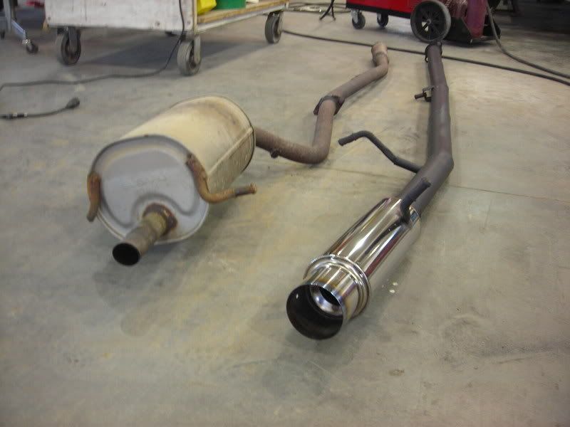

    First off, thanks for all the suggestions everybody. I had my car on jackstands Thursday night while I was painting my wheels and decided to do the exhaust myself cause it looked so easy. I did a full cat-back for less than $50, and have the satisfaction of saying I did it myself. :cool:
    Here's some pics:

    wow...looks pretty good. What size piping did you use?
  31. briancustoms
    Thanks, it's 2.5"
  32. fobiawrx
    fobiawrx Fabiola
    looks good
