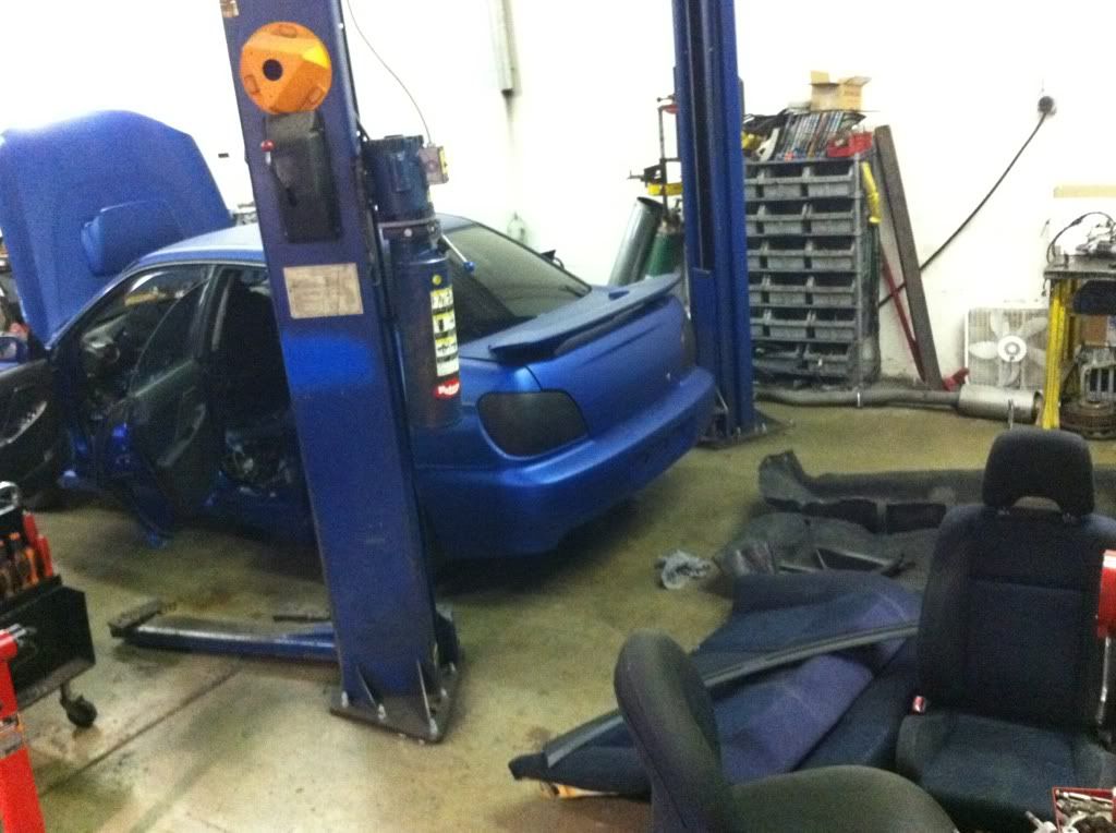

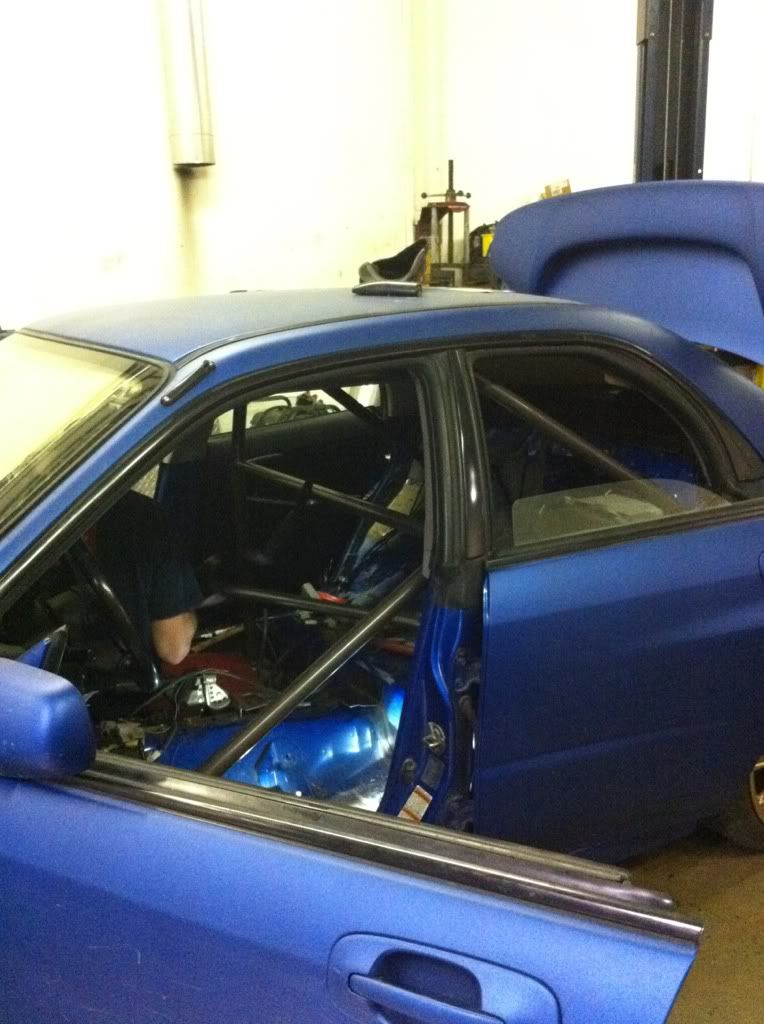

  5. Ronnie@RSmotors
    104
    The day is was torn apart to get the cage in.

    nice cage! you got one hell of a fabricator!
  16. Ronnie@RSmotors
    104
    There he is. Master fabricator, Matt Haynie (fobia). Amazing how he comes up with ideas how to start and finish a project.

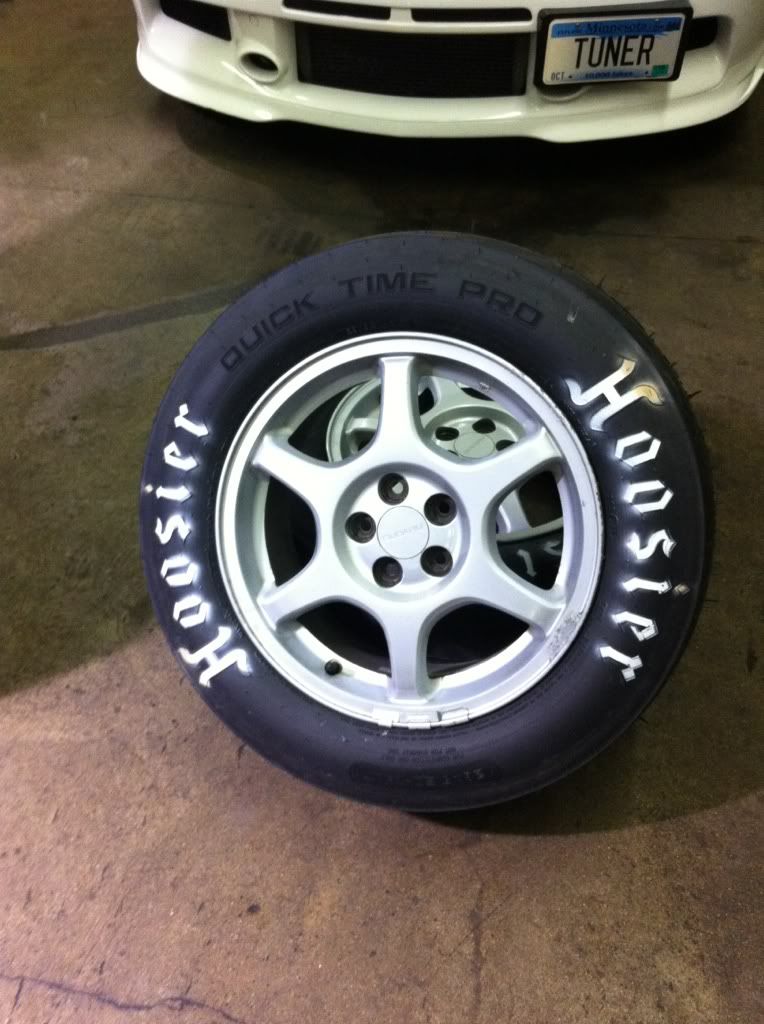

  29. Ronnie@RSmotors
    104
    New shoes. Bummed that only 2 came in. I have to wait for the other 2 next week.

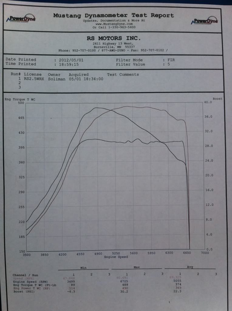

  34. Ronnie@RSmotors
    104
    At 22 psi, it put down 417wtq and 342 whp.
    2.5 block, stock 04 heads, Manley rods, cp pistons, twin exedy clutch, jdm 02 STI 6 speed, LSD rear diff.
    New turbo will be here next week. I'm keeping the car balance between drag and road race. Goal is 500whp and 480 wtq. Which ever one comes first.

  38. Ronnie@RSmotors
    104
    Yes vf 39. Boost goes up to 22 then falls right away to 14 by 5500rpm

  40. Ronnie@RSmotors
    104
    Upgraded to the FPblack about two weeks ago. Finally got the fuel system upgrade along with my own dual pump set up.
    Then on the Dyno before I left work today. New numbers 490whp 489tq at 30 psi

  44. samoya22
    samoya22 Well-Known Member
    I'm excited. Is pulse-width still limited?
