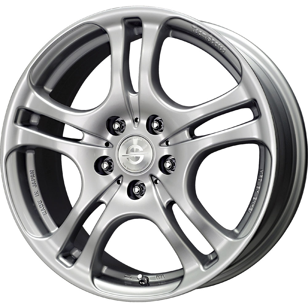

    No, offset problem. My BBS RE's are 50mm. I prob need in the 42mm range.
    Looking at these:
    Sparco Racing made by Enkei.
    $121 at Discount. I knew that as soon as I got my 255's they wouldn't fit. I'd rather have forged and not sure how much these weigh.
