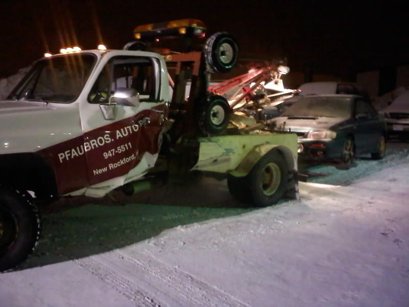

    After the tow truck managed to get out of the ditch:

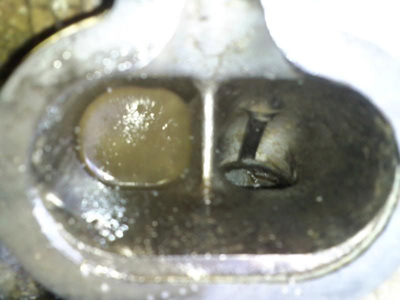

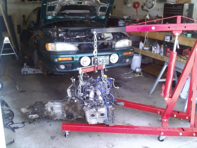

    Well I finally got the motor out and had a chance to look at things a little closer...
    Can't wait to rip this thing open and get some good carnage pics!

    John16V Well-Known Member
    Oh my....... any idea what causes this?
    GL
  21. HiImBrian
    HiImBrian Member
    Well when I drained the oil there was a steady stream of coolant for like 5 seconds so I
    assuming that my hgs went. What really sucks is I just had em done about 10k ago when I bought the car. The guy I bought the car from is a mechanic so he did the hgs when I bought the car. Nothin I can really do now though but find a new motor :(
  22. piddster
    Wow. So some how you have coolant/oil goo on top of one valve, and what looks like piston shrapnel above two other valves along with one valve that is bent in a really interesting way that would look nice at the edge of my desk, lol.

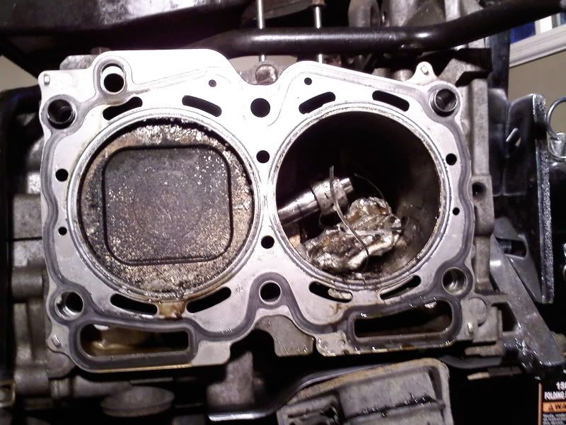

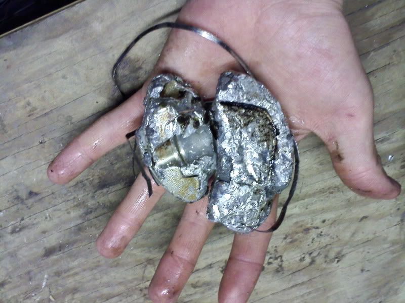

    I finally got around to taking the heads off. Yea I know, it's taken me forever. The carnage is pretty sweet though lol.
  26. errorcode3
    errorcode3 Member
    that should buff out right?
    no wait, isn't it supposed to do that?
  27. ricetiva
    ricetiva Well-Known Member
    Jb weld son!
