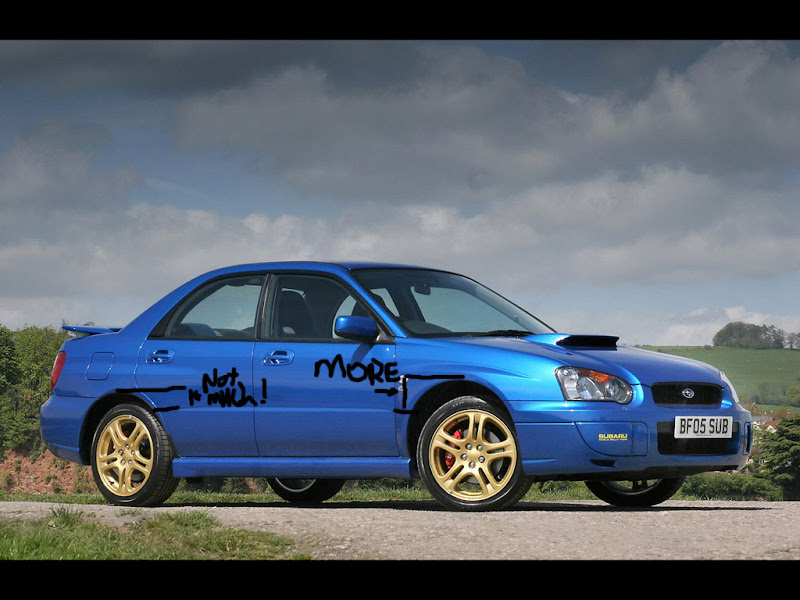

  15. Shibbs
    The stock fender arches in the rear aren't has high as the arches in the front. A perfectly level car will have LESS FENDER GAP IN THE REAR. The easiest way to tell this is by looking at the body lines on the car. (I can't believe you're making me break out photoshop~)
    Yes, that line is level, yes I measured it on mine. (I did sweet painter's tape grafix, y0.)
    lolololol and lololol
    If you really want to fix it, and you don't care the quality, the cheapest route is to put spring clamps on the front, to lower the front to the level of the rears.
    If you want to do it correctly, there are companies that make "saggy butt spacers" (no lie, that's what they're called) and they are available in several widths. That would essentially raise the rear of the car. So. Low = clamps on the front. High = spacers in the rear.
