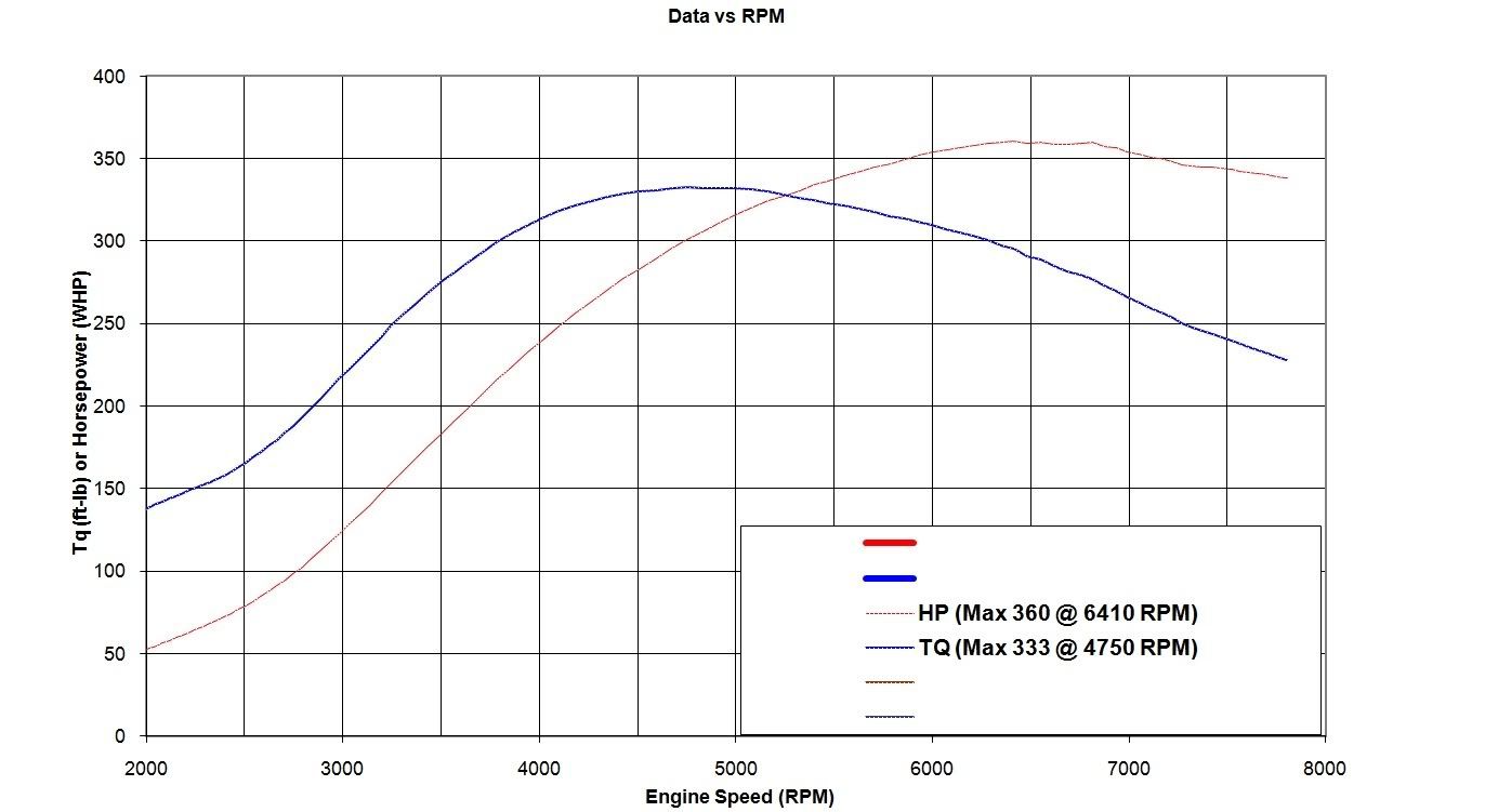

Thought so... Some have asked me about it, and know I'm a 2.5L type of guy. Some question if it's worth it. Some would like to feel 8000rpms :laugh: Tonight was just a test. A very basic base of how it goes @ just 20psi on the 20g on e85. My opinion? Not bad at all BTW, you should know who's car this is... Should I turn the knob and make it 9k the next run? Haha! Sorry for the big pic Updated post #19
I would like to see the comparison between pump gas and E85. Also, (silly qn) I was expecting the torque to be more than that or is that what is expected with a 20g?
I don't feel like reading all of that haha. Is he running stock bore and stroke dimensions? In my nasioc surfing I saw he commented a few times on someones de-stroked build.
No pump, no need to go back 2.5L w/ 20g will make more tq. the 22t's stroke is the same as the 2.0 Pretty much stock 22t bore with the same stroke, but is now a phase 2 crank, not phase 1 Wasted no time, finished around 1:30ish this morning. More results tonight.

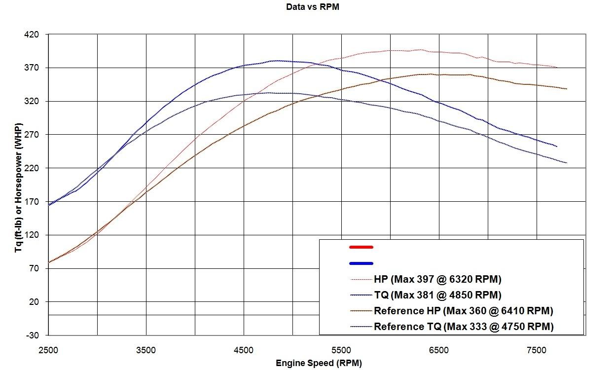

lol... First post: 22t w/ ej255 heads, stock, with stock cams, stock intake manifold, stock exhaust manifold, stock wrx tmic, stock wrx bpv, ported tgv, modded dark blue injectors, walbro 255, 20g sl2 8cm internal wastegate, tbe and 3 port solenoid. 20.5psi tune with e85 From tonight, differences: Fobia's custom UEL headers, aps uppipe with fobia's ewg, tial 38mm vband, ebay tmic, forge bpv and a mbc. 22.5psi with e85 Oh yeah, don't forget, somehow it got infected....
Oh I see, I didn't think JUST ewg would add 37hp...but with fobia magic, some kind of virus, and 2psi, it all makes sense
