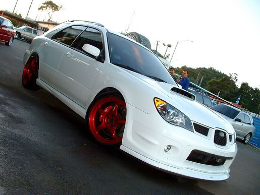

    I'm picking up some silver RS 5 Spokes and was thinking of spraying them. My top choices are either Black, Gunmetal, or Anodized Red. I just found a pic of a white WRX wagon on Anodized Red wheels and I think I'm in love...what do you guys think? Just wanted something kinda "out" there ya know...or be boring and keep the silver (not a big fan of silver wheels on white cars)? Haha...thanks!
    These wheels...;)
    Sporting this color...:eek:

    no hair if you do not pait them red. I think it looks hawt...

    Go for it. why not? I'm not sure about the anodized look I'd maybe just paint em. If you don't like the look the can always be refinished.

    True, it's just paint...Dupicolor makes Anodized finish spraypaint, so who knows, maybe, we'll see...

    I say go for it ~ I personally am a big fan of red! Besides it's your ride, don't worry about what other people think, do what you like and enjoy it. Just my 2 cents.

    A little too much for me BUT that is very hot.

    That looks sweet! I would have never thought of red wheels
