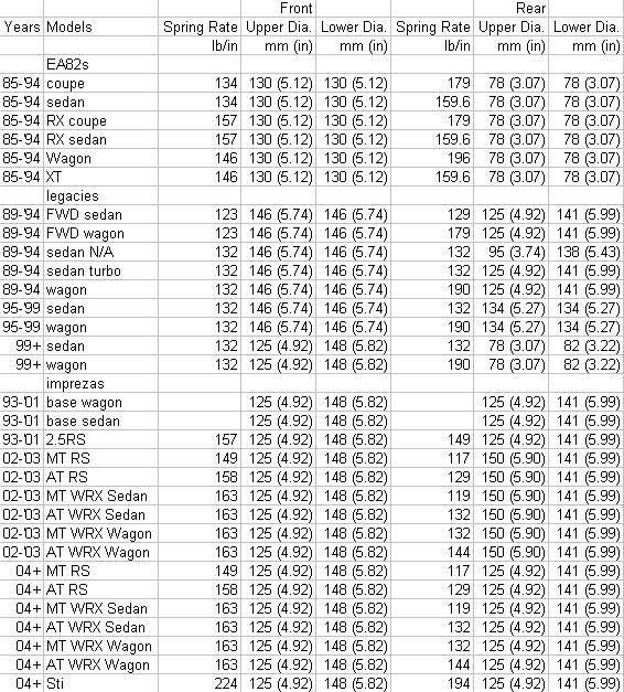

  16. Chux
    1,489
    worship my spring cross-reference chart of doom (and please....let me know if there are any corrections....)
    that should help you know what springs you have, and what other models will work.
