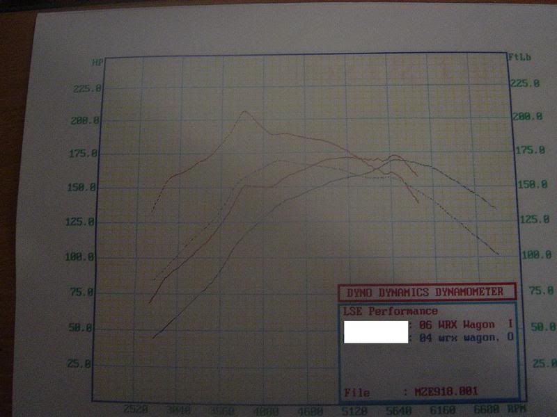

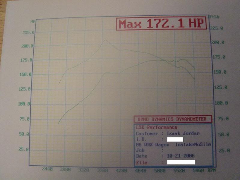

    I went to the dyno today at LSE Performance in Osseo, MN. It was for an autocross dyno day and we also did a comparison with a stock 04 WRX wagon.
    Here are the results:
    172WHP / 210WTQ for the bone stock 06 subaru WRX wagon.
    The 04 WRX wagon was around 160 WHP / 170 WTQ
    the 06 Has a GP moto intake silencer delete elbow. We didn't count this as a modification but noted it anyways.
    my 06 wagon pulled higher WHP and much higher WTQ than a 96 Mustang cobra, that was amusing.

    actually boost never got above 12psi

    Do you have a scan of the boost vs hp/torque printout? I wonder what causes that big spike in torque?

    nope they were kinda pressed for time so i was going to go get the AFR and boost vs hp sheets later.

    spike in tq seems to be common. take a look at these:
    they all have the same bumps in the same places.

    Maybe that bump is where the TD04 is at its highest efficiency when paired to the EJ25.

    I'm wondering if it has something to do with the AVCS perhaps?

    I think its peak boost also. The 2.5L has no problem spooling the tiny td04... it just has nothing up top.
    Here's my dyno graph from LSE a month ago (06 stage2) and a third gear ecuexplorer datalog from 2 weeks ago. As expected the initial spike in torque is when the turbo is fully spooled at about 3400 rpm. Meanwhile the HP slowly rises until boost starts rapidly falling at about 4900rpm...
    The "spike" isnt quite as abrupt as Zak's but that's likely factory tuning right?
    Time Engine Load (g/s) Engine Speed (RPM) Vehicle Speed (MPH) Manifold Relative Pressure (PSI) 17:45.8 21.57 1803 25 -9.286 17:46.2 37.65 1815 25 -6.529 17:46.6 47.45 1870 25 -4.643 17:47.0 52.55 1914 25 -3.773 17:47.4 55.29 1972 26 -3.192 17:47.8 56.86 2035 27 -3.047 17:48.2 56.08 2084 29 -2.902 17:48.5 58.04 2153 29 -2.757 17:48.9 57.65 2230 29 -3.047 17:49.3 59.61 2288 30 -2.757 17:49.7 66.27 2361 31 -1.886 17:50.1 100 2471 33 4.063 17:50.5 100 2626 34 7.4 17:50.9 100 2828 34 10.882 17:51.3 100 3040 37 13.639 17:51.7 100 3250 39 14.075 17:52.1 100 3484 42 13.929 17:52.5 100 3703 46 13.929 17:52.9 100 3943 50 14.075 17:53.2 100 4138 50 14.22 17:53.6 100 4343 53 14.365 17:54.0 100 4518 57 14.365 17:54.4 100 4766 61 14.22 17:54.8 100 4930 65 13.639 17:55.2 100 5149 68 12.914 17:55.6 100 5314 68 12.043 17:56.0 100 5481 71 11.318 17:56.4 100 5646 75 10.882 ...
