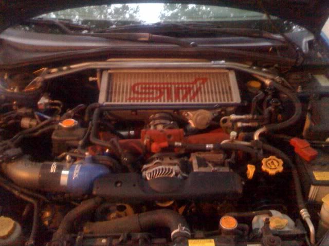

    boutght a dual bar brace....
    one of the bars seems to go over the the tip of the top mount intercooler and vibrates Grrrrr.... looks like it could use a few MM of clearence and then the issue would be solved...
    anyone have similar issues? know a quick fix?

    quick fix: washers on the strut studs under the strut brace?

    IS it rubbing on the AC line nearest the driver's side strut tower? If so, there is a 3 bolt clamp for the AC line (2 on the firewall, 1 on the ac line)that you can undo or modify. You can also carefully bend the ac line in that area.
    I had the same issue with ebay strut bar/stock intercooler on an 07 STI and washers didn't quite work (unless I stacked 3-4).

    nope, corner of the intercooler..
    I moved the piping allready. :(
    I wonder if I unbolt the nuts that bolt the bar to the braces if I can raise the bar a little ..
    I thought the loops where the bolt goes through were larger then the bolt....
    could be wrong.

    see how it sits pretty much ON the intercooler
    right where that little tag is on the bar, thats where it's rubbing...
    rubbed hard enough to scratch the metal on the intercooler and the bar.
    just barley tho... so just a hint of clearence should clear the issue...
    i'll have to try washers, or maybe make a custom plate. OOooo
    I wonder if grimspeed could cut some spacers for that??

    Have you tried adjusting or bending the intercooler mounting bracket on the drivers side (the one that bolts between the intercooler bracket and the intake manifold)? There is a little bit of wiggle room with the 2 IC mounts.
    Obviously don't bend it too much, and you'll likely need to adjust the passenger side DP to intercooler bracket if the angle is way off.

    well ill try some washers, if that doesnt work...
    it's for sale I guess.. :: pout::
