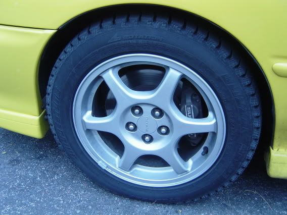

    I have the JDM 4 pots on my GC. The 6 spoke RS wheels just barely clear them, but they work fine. The rears will fit easily. Theyre the sme size and rotor size as on the 06 WRX, but you can get the JDM ones in black or red. They bolt to the stock locations.

    the RS 6 spoke were also designed for the 4pots. they are the jdm STi wagon wheels.

    The old RS 5-spokes will also clear the old STi 4-pots:
