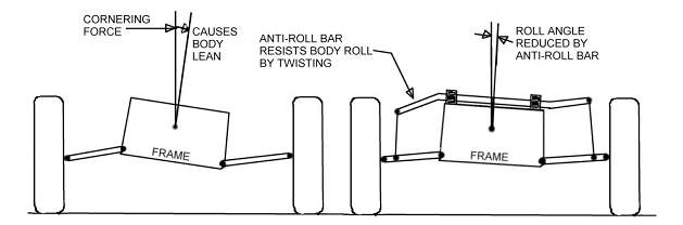

    Here, this is from the nasioc faq.
    See how the bar kind of "pulls" against the frame to reduce roll.
    Conversely, a spring acts in a similar way in that a stiffer spring will "push" against the motion of the frame as you turn in.
    Keep in mind that wrx's are kind of roll happy to begin with.

    Yes, the theory I have heard is related to mounting, but nobody has shown me concerete evidence (that is irrelevant here, anyway). I do not disagree with your assessment, but I was using it as just an example that not all "bad" struts have the signature of underdamping. In my experience, I never had the tell-tale signs of a blown strut (I have gone through several STi struts). The last one was quite bad, but it was all related to the strut sticking, not being blown. It acted like there was no suspension travel (a bit of an exaggeration) in the RR corner causing some very nasty behavior (like massive oversteer in low traction situations, i.e. snow). Anyway, springs and roll bars do not do the same thing, but they are pretty close. The roll bar actually uses the force of the bar to 'lift' the other side of the suspension causing the car to flatten out...springs are independent of each other.
    In the end, I asked if it was behaving bad over a bump on a single side of the car (roll bar or possibly a strut) or if the bump affected both sides of the car (likely springs or both struts).
    One thing to note is that a roll bar acts on "differential" properties, not "common mode" (in english: for roll bars, it only "affects" the suspension when one side is in motion while springs come into play when both sides of the suspension move together [assuming that something isn't straight up broken])
