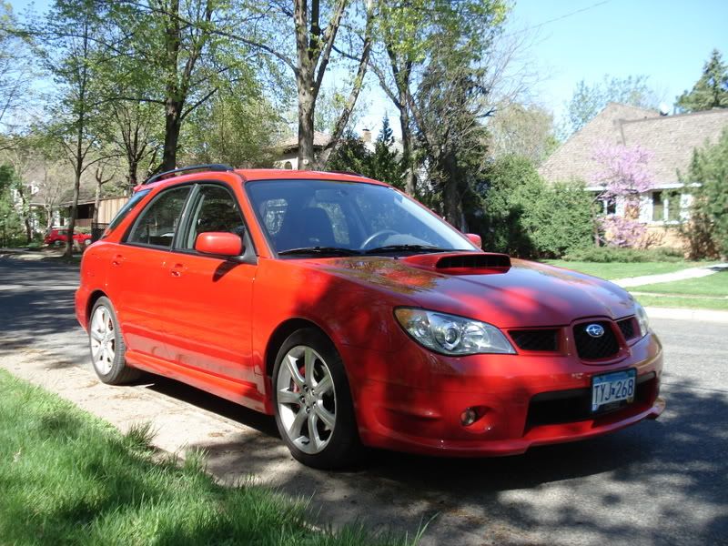

    I got my whole setup finally installed yesterday.
    Whiteline 22mm front swaybar + Whiteline heavy duty endlinks
    Whiteline 22mm adjustable rear swaybar Whiteline heavy duty endlinks
    Whiteline detachable rear strut tower brace
    KYB AGX GC front struts and GD sedan rear struts
    STi Group N front and rear top hats
    Prodrive springs

    Wow Zak! Looks nice, probably riding a little more to your liking now, huh!?
