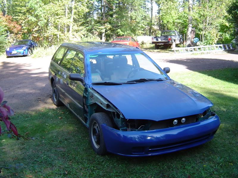

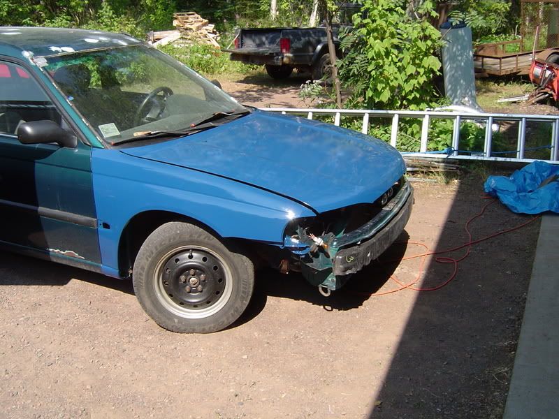

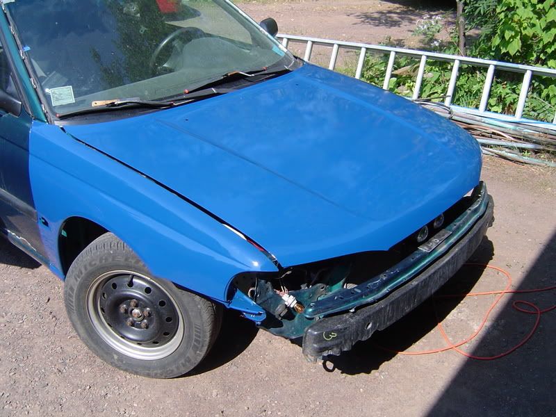

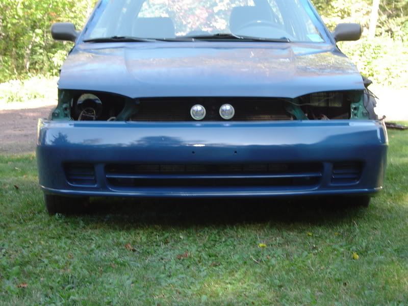

    well as i have said to some, i was guna give the "50 dollar paint job" a shot with my wagon. i went with interlux brightside topside paint in saphire blue. Sprayed on with a HVLP gun and a little 2hp compressor. been doing a lot of body work to get to the painting stage, but the blue is starting the get sprayed on now. its lookin pretty kick ass, so i cant wait to get it finished, also just put my first coat on my bumper and drivers fender yesterday but no pics. im still yet to sand or polish anything yet, but really happy with the amount of orange peel in most places already. full progress can be seen in my album here..
    http://s4.photobucket.com/albums/y105/StatGSR/Legacy Body Paint/
    i'll continue to update the farther along i get.

    ^ you dont clear single stange paint, or atleast its not nessicary.... all rust spots were hit with rust reformer and and a coat of rustuolem before fiberglassing.

    after i cut away all destroyed metal, remaining specks of surface rust were covered the way i described. if u look at my other pictures u will see the gaping holes i cut out of my car...

    ^ cause its a winter beater, that takes even more time, i dont own a welder and cant weld for beans. and the last thing im guna do is pay somebody to do it. defeats the point of a 100 dollar paint job....

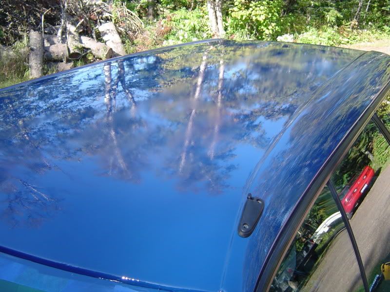

    Update! fenders, bumper, and roof are all painted. hood is wetsanded but only partially buffed, but it looks great. project is taking forever now since i only get to work on it during the afternoon on weekends (weather permiting), but im sure hoping to finish before snow fall haha.

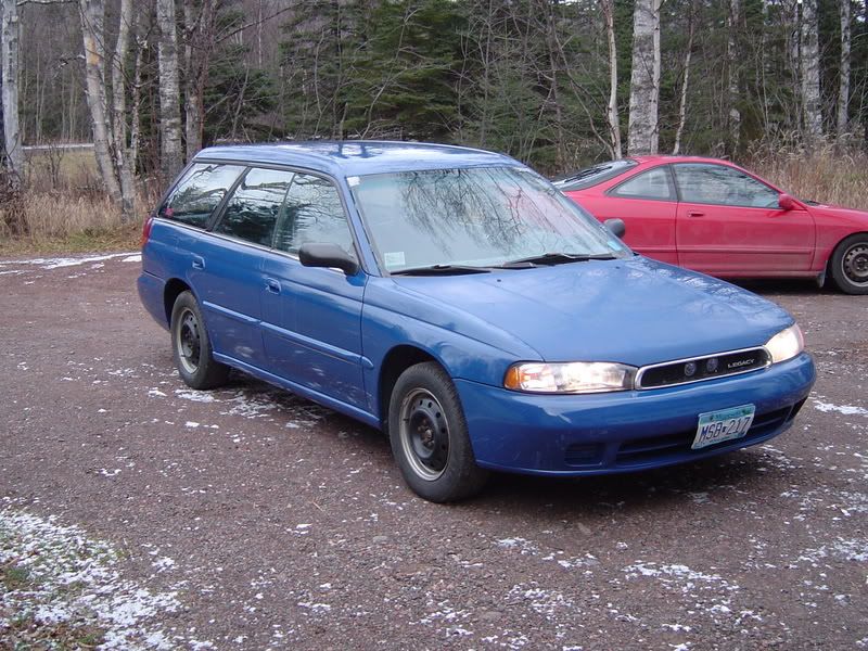

    Everything is blue that needs to be blue!!!!! bad news is my camera batteries died. so no pix, but its still not put together anyway. ill have pics after assembly in 2 weeks, when i go home again and pull it out for the winter.

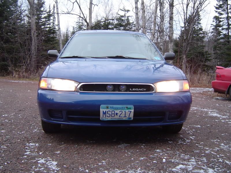

  45. StatGSR
    StatGSR Well-Known Member

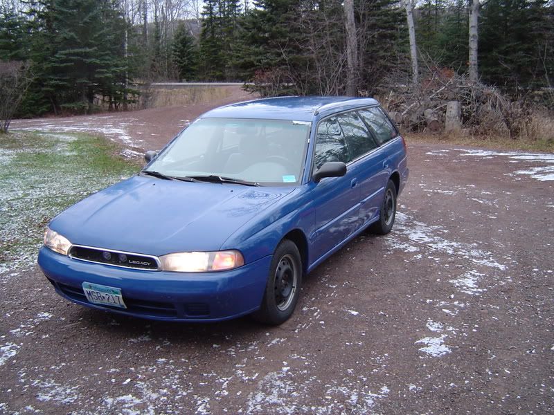

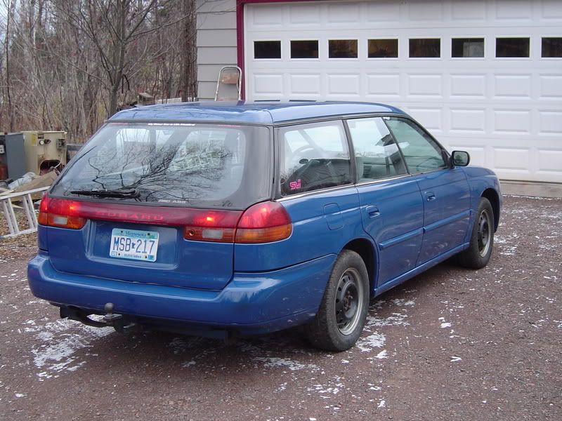

    w00t! its done kinda. haha its all blue, hood still needs polishing and so does the drivers side head light, but im lovin it!
