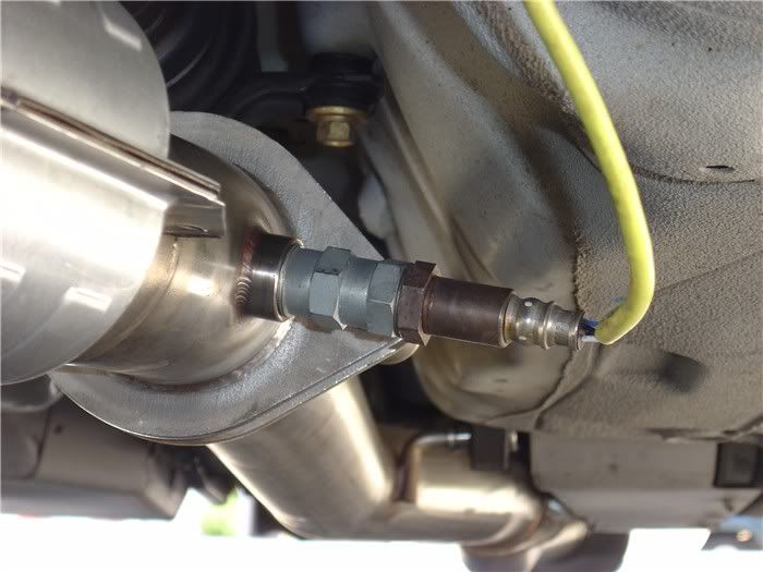

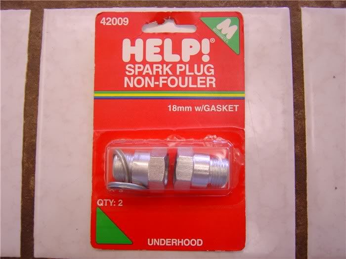

    Problem solved!!!! temp 4.00 fix!!!! WOOT!
    1.Go to your local auto parts store and buy this:

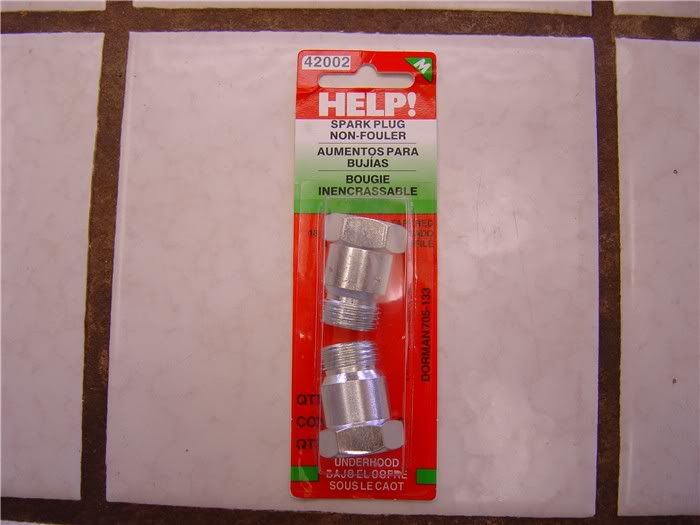

    or you can also use the #42002 version, all your preference:
    2. With a 1/2" drill bit, bore out only ONE of the anti-foulers in order to accommodate the size of the o2 sensor head. Screw in your o2 sensor into the bored out anti-fouler then screw that into the other untouched anti-fouler and voila!
