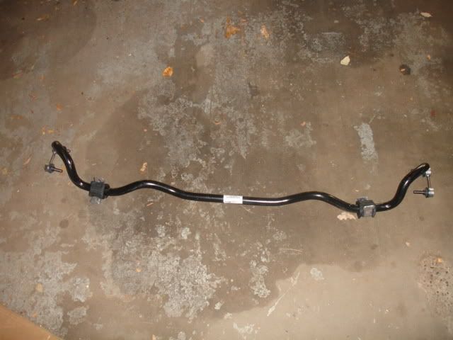

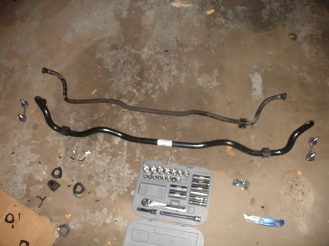

    Here it is, all laid out (minus the swaybar brackets) :
    All of that cost less than a new Whiteline FSB. You may notice that some of the parts I bought I didn't use. The clamps on the Tribeca use two bolts (one in the front and one in the rear) as opposed to one bolt on the T-leg (one bolt in the front and a tension flange in the rear). I didn't know this up front and bought the parts just in case. The NASIOC guys recommended using the rear STi endlinks but I couldn't figure out how to install them properly without putting seemingly undue tension on the lower bolt. All of the stress across the lower bolt would have been put at the two narrow points where the bolt passes through the lower control arm bracket... I didn't like that so I used the stock endlink. A future upgrade will be beefy front endlinks (a la Whiteline or the pretty purple kind). I also bought the Rear swaybar mounts from an 04+ WRX. The stock t-leg/GC/02-03 WRX mounts are pretty flimsy, and when I upgrade to a big rear swaybar (now a sure bet) I wanted something large to hold it. Something large that doesn't cost a ridiculous sum of cash from Perrin/Whiteline/anyone else. Anyway, back to the install.

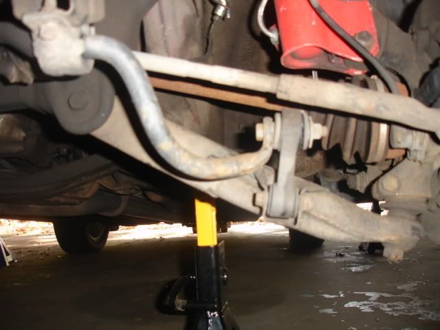

    Once you get to this stage you've got a nice view of what your working with:
    Notice how the stock swaybar runs underneath the tie rod and attaches to the inside of the endlink (You're looking at the drivers side from the front). The Tribeca swaybar, due to its design, will loop over the tie rod and attach to the outside of the endlink.

    6. Place the swaybar on the ground and admire the contrast between the coathanger you've just taken off, and the true piece of heavy-duty machinery you are about to install. Mmmmmm.... tasty.
    7. Get out your utility knife and start carving up those Tribeca bushings. Cut off the lips on both edges, and on the top (flat) side you'll need to remove between 1/4 and 1/2 inch of rubber to get it to fit in the stock clamp. Be careful, that utility knife is sharp.
