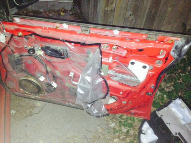

    Alright, so i got the door card off and i'm cruising....
    amd then it comes to getting this SOB off....
    PDF says to use the power switch to move it to an access hole but along its entire movement there isn't a hole as its sitting directly behind the door lever... any thoughts?

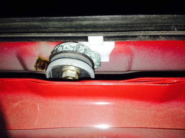

    Lastly,
    How do you get this window hardware off? There's the four hole on this side and a flat round screw on the other...
  30. Chris Ruhland
    Chris Ruhland Member
    140
    48
    I'm stumped. I can't figure out how to get the front glass mount off or into a position where i can get it off. Anyone know of any videos on taking out door glass? I couldn't find any.
  31. tangledupinblu
    18,609
    MNBugeyeMafia#001
    Hmmm. I don't recall there 'not' being a hole to access the nut when the window is down. :(
    If i had time to come out there, i would!!
    Chris Ruhland likes this.
  32. phi11
    3,798
    Action Valley
  33. Chris Ruhland
    140
    48
    phi11 likes this.
  34. tangledupinblu
    18,609
    MNBugeyeMafia#001
    Oh yes...remove the speaker!
    Cotts612 likes this.

  37. EricS
    EricS Nooberator
    1,975
    Saint Paul
    To me that looks like something that I'd use a Pin Spanner Wrench on, like this:
    http://www.harborfreight.com/adjustable-pin-wrench-36554.html
    You might be able to kludge one up from some thick wire if you have that around, or for a one-time use like this maybe find a piece of flat bar, (or even wood?) drill two holes in it the right distance across, drop some bolts of appropriate diameter through the holes and put a nut on the far side of each - instant custom-sized pin wrench :thumbup:
