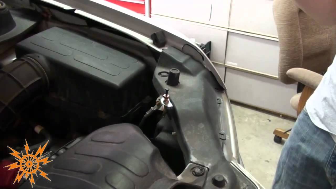

    I had something similar with my viper alarm. Turns out it was the hood immobilizer was off tilt fixed that and fixed the problem. There should also be a way to put it on limp mode or valet mode. its a combination of taps to the receiver button on your windshield.

    Fob has brand new batteries both fobs lock and unlock the doors. I'll check into the hood immobilizer. I'm assuming that's around the latch area?

    yeah just look around. Looks like this. [​IMG]

    I'll see what I can find. I'm not sure mine came with one.
