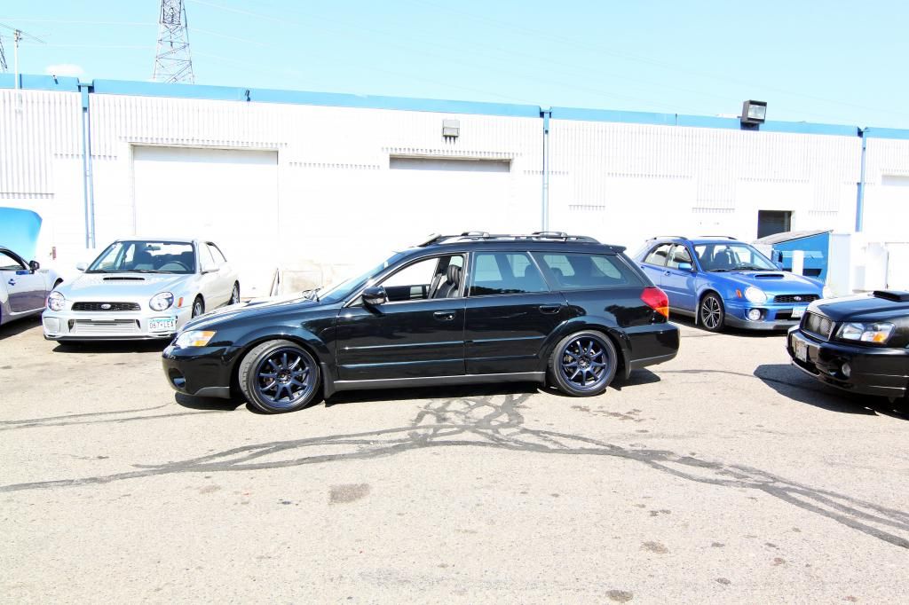

    On Tein Flex.
    AndyBoyee likes this.
  37. Kenny Mey
    Kenny Mey Member
    29
    Wow I like it!
    How does it ride?
  38. kongzilla
    kongzilla Well-Known Member
    759
    I went through a bunch of suspension setups before I settled. I'm super picky also.
    -BC coils: they bounced all over the place. Regardless of what setting I was at, it felt like crap.
    -Koni yellow/epic springs: I love this setup. But the koni were still a little to soft. Ride height was perfect.
    -JDM Spec B Blisten Rev A: great setup, felt great, not too harsh and not too soft. Should of never got rid of it. Waited 2 months to get these. could use more low.
    -Teil Flex/EDFC: current setup. So far its all of the setups I used to have combined into one. Best setup so far. only flaw is I can't mount my EDFC since my rear struts sits too close to wall supports.

  43. kongzilla
    759
    Spring rates were whatever they came with. I believe they were 8/9. The flex is 16 way adjustable and it is set at 9 both front and rear. The rear should be upped a bit. Its a little soft back there.
