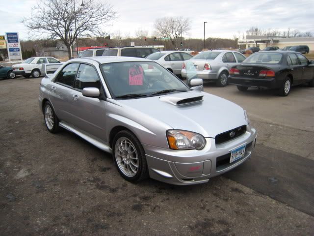

    I bought a silver 2004 STI from a little car lot in shorewood called Tonka Bay Auto, just wondering if someone on the site owned it? I ask because it has a bunch of stuff done to it but the dealership wasn't sure of the mods. I know it has a bigger turbo, bigger intercooler, loud ass bov, cold air, Invidia down pipe to espelir exhaust, an aftermarket clutch and i'm guessing some sort of tune since it had an accessport owners manuel in the glove compartment. The thing goes like a raped ape, just wondering about any background on the car, timing belt, fuel system mods etc etc.

  2. readymix
    Was Manuel ok?
    Welcome to the site. Also, an underhood shot might help some of us identify who owned it before you. I don't remember those wheels locally, but I may remember the mods if it is an 04.
  3. curly2k3

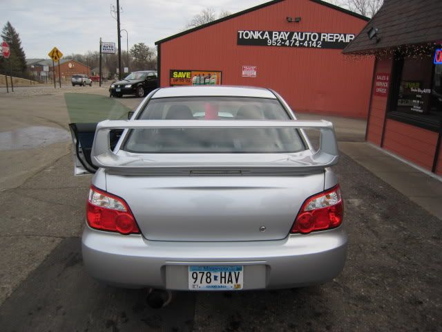

    I would also strongly recommend a tune if you got it from that dealer, when I was talking to them before it seemed like they like the idea of just tossing on parts and beating the piss out of them. I'd also double check the car's history, seeing as they were trying to sell a JDM STi and saying it was road legal as is.
  4. readymix
    I think you're thinking of Minnetonka Imports or whatever they were calling themselves. Tonka Bay Auto is VW/AUDI

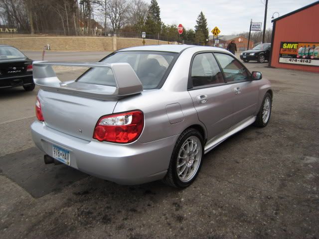

  6. curly2k3
    well pic two made it look like it was next door to the gas station and across from truffle hill, the fire station, and the bowling alley and stuff... if that's the case, same place, different name.

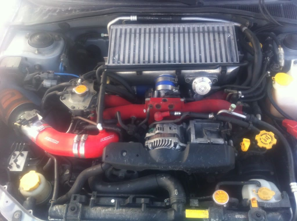

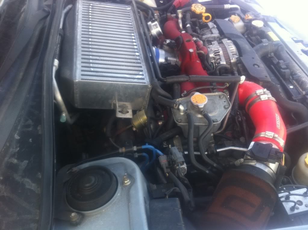

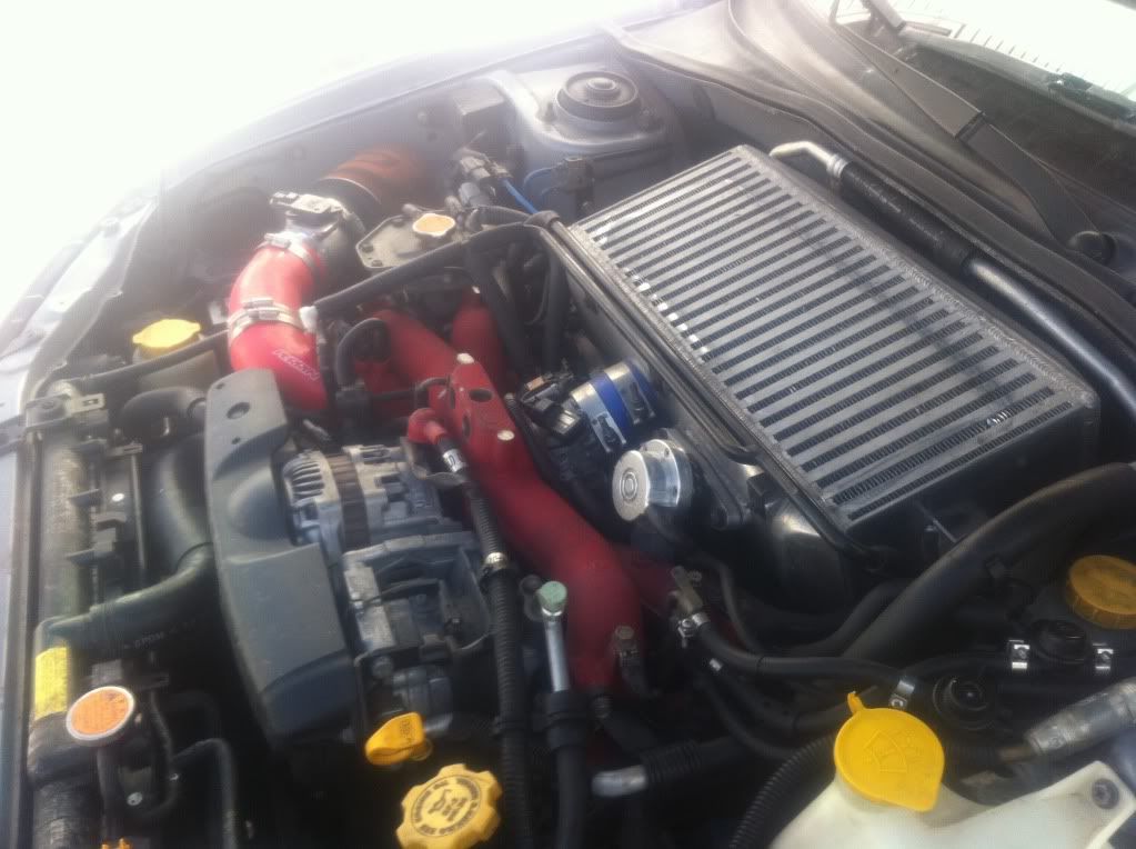

    Haha I agree totally on the wheels! I hate em! They'll work for winter wheels though, and I'll go snap a shot of the motor now and post it shortly. The car is mint though, only flaw is on the drivers door pillar. Looks like someone locked the keys in the car and had to pry on it, two dimples in the trim.
  20. 2002WrX
    2002WrX Well-Known Member
  21. curly2k3
    pretty sure scott and jake's roommates did have the flaw on the pilar, same car for sure.

  29. bikerboy
    94
    The first thing you should do is replace the front O2 and reset the ECU.
    intercooler: Perrin
    Intake: Perrin big maf
    Turbo: SBR 20G
    Injectors: IIRC they are 850 reds?
    Tune was done by Jorge on a V1 AP with a pump map and a 110 oct map
    I don't have all the details in front of me but the heads were rebuilt the last time I worked on the car. I would have to check the receipt to see all of what I did.

  41. delsovue
