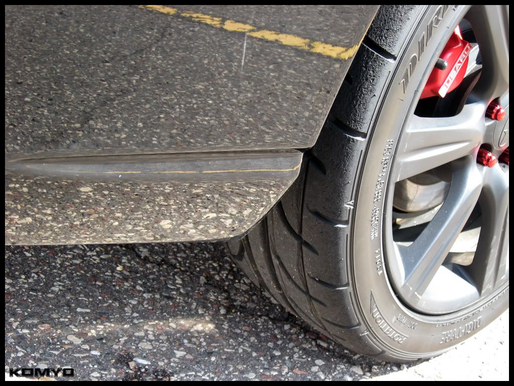

    I'm also running 225/45/17. Its slightly larger than stock, but barely. I've got them squeezed on a 7" wide rim, and they are very square in the shoulder. Very aggressive looking, IMO.
    Ideally, if you roll the rear fenders and want the most filled out tire possible, go with a 245/40/17 on an 8" wide rim. 235/40/17 also works very well with the whole rolling diameter as well.
    I personally say 225 is a great choice for a DD tho, because tires are insanely available and they are much more competitively priced in the more common size of 225.
