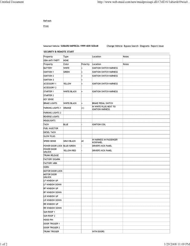

    I decided to tie wrap some of the wires that were hanging down from a alarm that came with the car. I got it all done and the car wouldnt start, after a couple hrs of trying to find the problem I decided to take the aftermarket alarm out(big mistake) car still wont start. Before the lights would work now the headlights dont come on at all .:eek: I might of cut a wire that went to the factory alarm. Does anyone have a wireing diagram so I can try to trace down where the wires for the factory alarm go?
    Its for a 99Rs with factory alarm

    This is right from the directechs webiste from DEI. SC= Steering Column
    12V-White-SC
    Starter-White/Black-SC
    Ignition-Green-SC
    Accesory-Yellow-SC
    Is it a Remote Start as well?? Does it have a starter kill relay?? If it does then that means that they cur the starter wire in half. And connected to the relay. IF it doesn't have a Remote Start then this should be all you need to get the car to start!!! From an Aftermarket alarm/Remote Start.

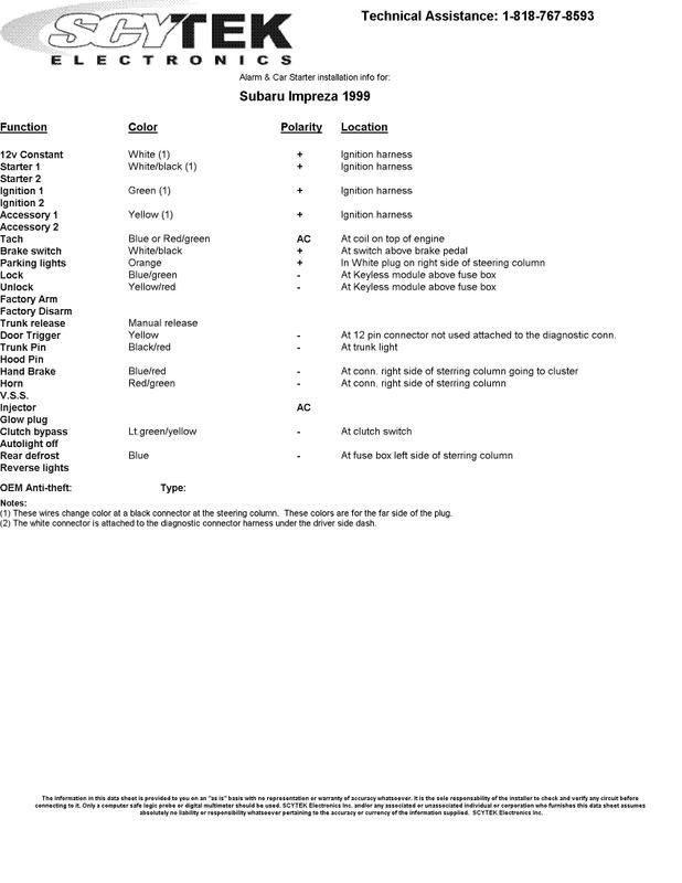

    There is the wiring diagram
    and another diagram
