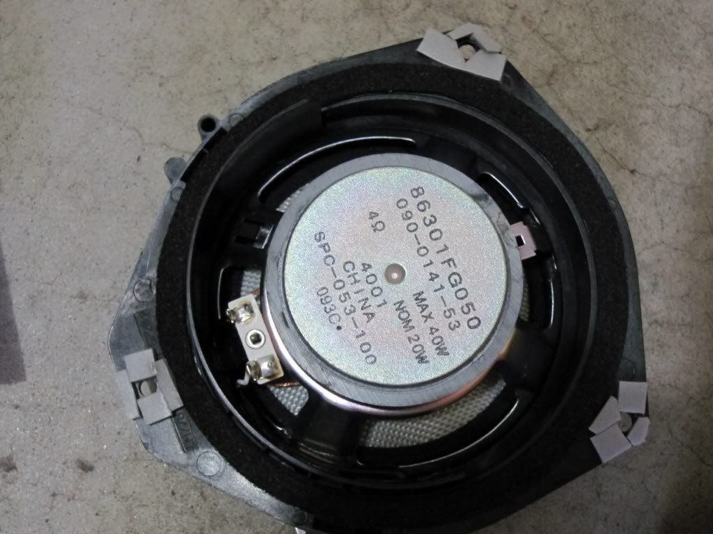

  5. xluben
    The 2011+ WRX has the upgraded "6-speaker" system and it is on par with aftermarket speakers. 2010 and prior WRX's had the crappy "4-speaker" system.
    4-speaker vs. 6-speaker:
    http://www.crutchfield.com/S-VwhmobGhq3a/learn/2008-11-subaru-impreza.html
    2011 WRX Stock Speakers (woven "Kevlar" cones, coaxials in all 4 doors, reasonably large magnets, and tweeters in the sails):
    http://forums.nasioc.com/forums/showpost.php?p=33126056&postcount=19
    Impreza, Forester, 2008-2020 WRX Stock Speakers (paper/plastic cone, non-coaxial, tiny magnets, no tweeters):
    http://mnsubaru.com/threads/xlubens-2012-subaru-forester-2-5x-premium.43326/page-2#post-730726
    The tweeters should be plug and play. Just be careful removing the sails. I destroyed both of mine in my Forester. They're pretty easy to break. They should be a very nice upgrade for free. Just keep in mind that the stock HU is the real weak spot. It still won't sound great unless you buy a new HU.

    The tweeters should be plug and play. Just be careful removing the sails. I destroyed both of mine in my Forester. They're pretty easy to break. They should be a very nice upgrade for free. Just keep in mind that the stock HU is the real weak spot. It still won't sound great unless you buy a new HU.[/quote]
    Thanks for the info and the photos, keeping my eye open for a cheaper HU or just bite the bullet on a new one!
