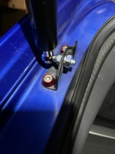

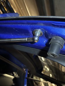

    Part 1 complete:
    Ordered some 20” 150# struts from Amazon. Open the hatch and it automatically goes all the way up. With some gusto, I’ll add.
    I bet 125# would be plenty. if I get bored, probably, I’ll order some and find out.
    New sedan keyless entry module gets here tonight, hopefully I can install this week and get the key fob to work.
