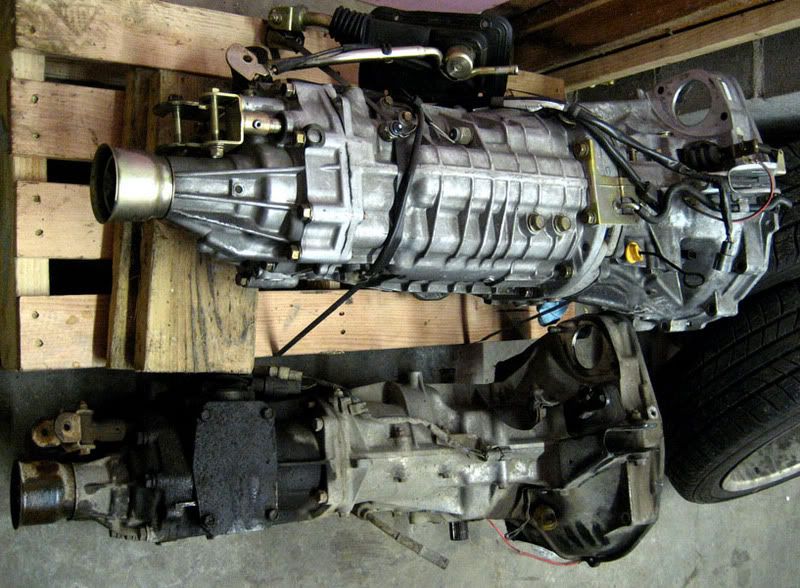

    Is it possible? Im just curios about the whole thing. Can anyone give me some links or any info on DCCD. Thanks for the help.

    Not without the 6 speed that comes in the sti

    oh yeah, buy an sti tranny

    as hinted already...you can't just buy a DCCD controller and plug it into your WRX trans. you need the STi tranny aswell....
    and even then it's a big job.

    You would have to swap out the transfer case.
    If you just want a 35:65 then the Cusco Tarmac center diff will do you good.
    If you want the 35:65 and added LSD effect, then it would have to be a transfer case swap, OR a DCCD tranny 5spd or 6spd.
    I'm just looking at getting the Cusco Tarmac gear for my tranny setup.

    A transfer case would have to be from its respective transmission, ie 6mt does not =5mt
