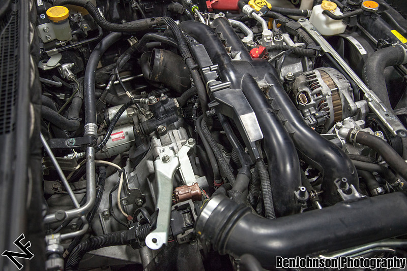

  5. xluben
    Definitely looks very similar or the same as the 3G WRX hose. Here's a photo of yours:
    Is yours damaged? How do you think the new one will help?
    Maybe just clean/dry it and then use hairspray?
