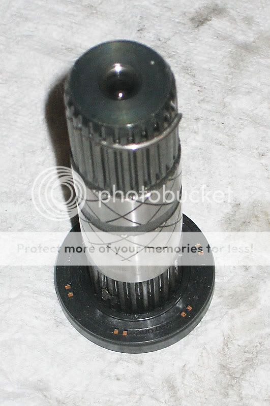

    And I need some STI stubs like this:

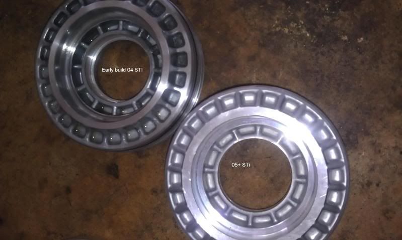

  5. Zombie
    Zombie Well-Known Member
    It depends on the transmission you have. The early 6sp transmissions have an extra lip on the bearing retainers so the axle seal does not mate up correctly with the end of the male axle. The dust lip of the male axle actually hits the bearing retainer before it snaps in. The dust lip could be removed from the axle but I don' t think the seal would live very long that way.
