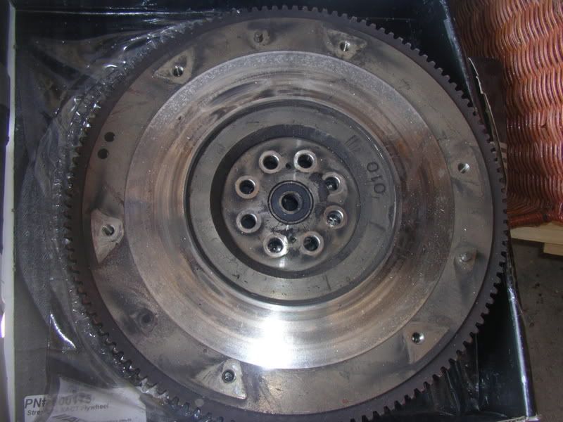

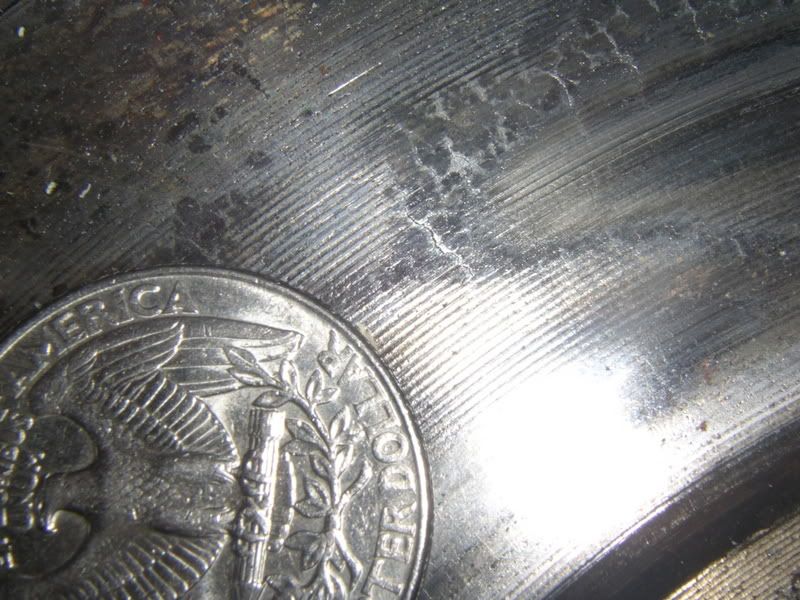

I went out and took another look and saw some small hair line fractures in the surface of my flywheel too, don't know how big they can be before it would be considered unusable, here are some pics: This pic is of the biggest crack I could find, seems the macro function on my camera found some more in the same area that I couldn't see: Thought I'd post these up here...I wouldn't want you to drive all the way up here for nothing.
