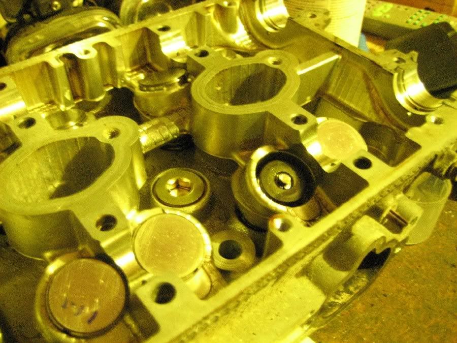

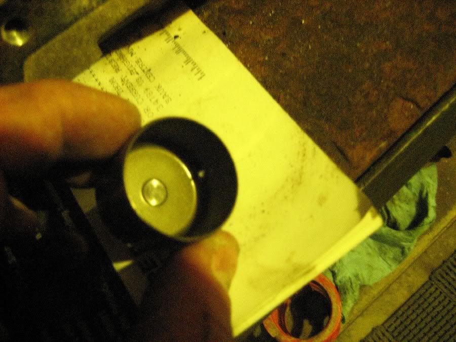

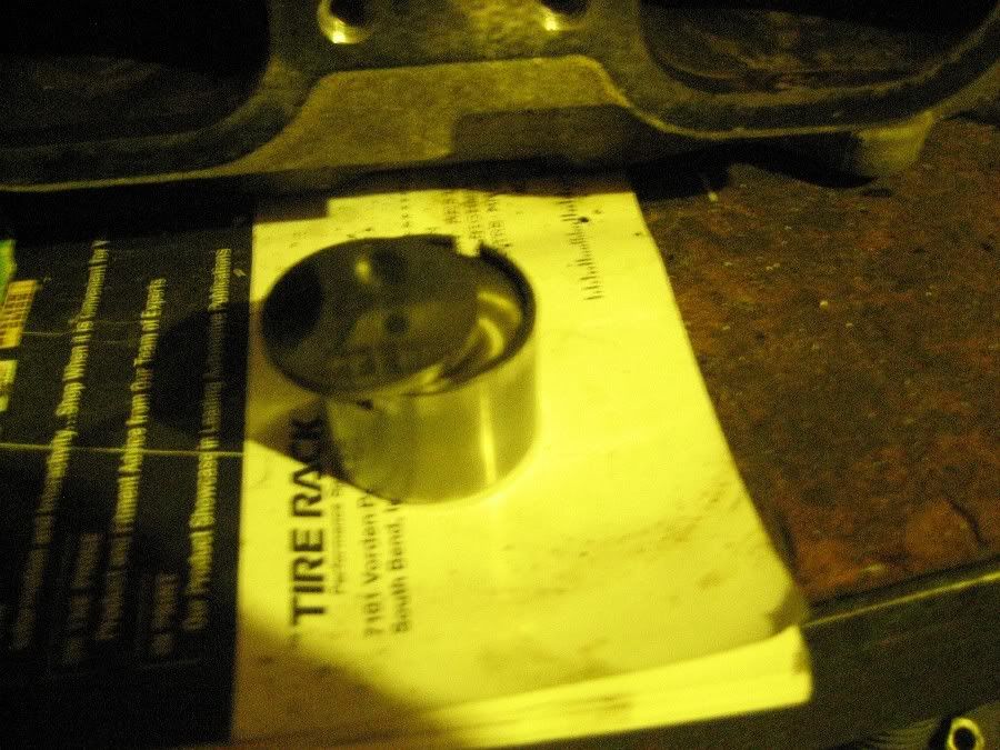

  16. piddster
    I just happen to have an EJ25D head sitting here next to me on the workbench so I thought I'd throw up some pics to illustrate. The EJ25D is a shim-over-bucket design as you can see how the shim rests on the top of the bucket. My dillema is whether or not the WRX buckets work on these heads. I have a hunch they might as it would typical Subaru style to use the same stuff. Only if Jason would have remembered to bring that bucket to firestone on friday :roll:
  17. AspitFire
    the buckets i have from a 2.0 wrx head look idenitcal to that bucket. If you wish i can bring 1 or two to firestone. lmk
  18. piddster
    ^ That would be tight. I'll bring one and my digital caliper
