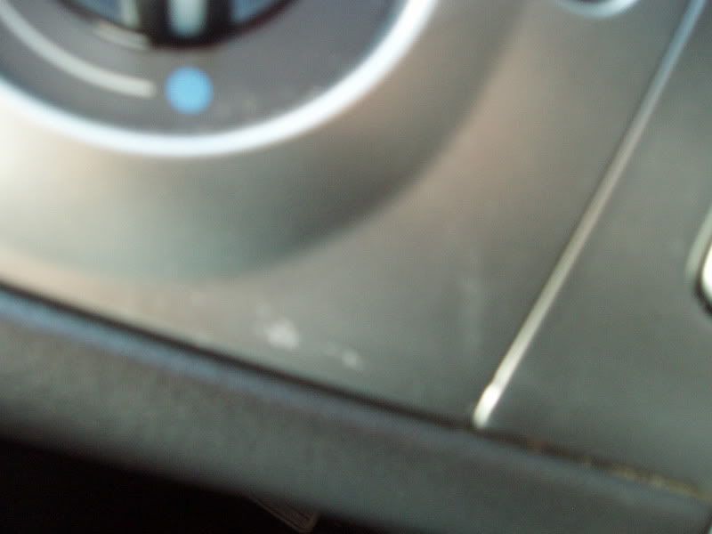

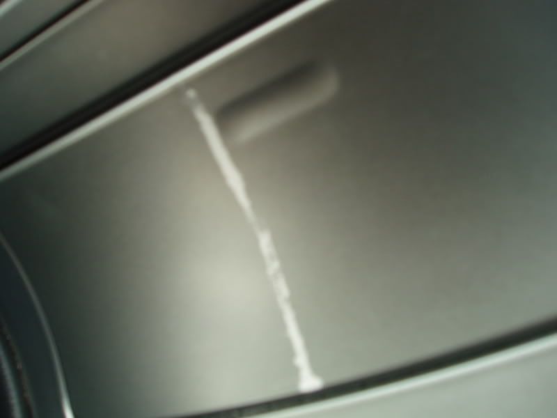

    so for the past few weeks the paint on my center consel has been flaking apart. i havnt used any substance to clean my interior. ive only used a static cloth for about a year now.
    WTF should i do.. what could be wrong?

  6. DISCOPOPE
    DISCOPOPE Well-Known Member
    17
    looks like something was spilled on it.
    maybe coke?
    it's quite corrosive.

  8. Squiggly
    Squiggly Squiggly
    175
    ok i started painting it black and it looks like **** so im gonna have to redo it
  9. TSTRBOY2004
    use proper plastic paint or interior paint... not normal spray paint... prepare the surface PROPERLY or it will just flake again...
  10. readymix
    Foolish newb. How dare you paint without consulting me.
  11. Squiggly
    Squiggly Squiggly
    175
    i consulted.. i did a bad job though and it needs to be redone.. are you offering help?
  12. readymix
    You consulted me on how to remove dash pieces, not on how to paint dash pieces.
    And yes, I can give you a step by step on how to paint.
  13. Squiggly
    Squiggly Squiggly
    175
    oh i assumed you knew what i was up to.. anyway i took the pieces off and taped what didnt need to be painted. then i used a fine grit sandpaper and roughed up the surface then added 2 coats of paint.. moderatly thin... and then a clear coat
  14. readymix
    You forgot primer. Absolutely necessary. And primer has to dry for, at the very least, 1 hour before you start messing with it. And as far as I know, on dash pieces, there is nothing to mask off...you pull them off, remove the hazard button and the vents, and then paint away.
    Eitherway, what grit paper did you use for sanding the surface before painting?
    And did you clean the surface with soapy water and rinse thouroughly before painting?
    And with clear coat, applying 2 very thin coats then a medium coat is the best way to apply it. Otherwise it runs.
    And what was the temperature at the time of painting...and humidity? There are lots of ways this can be F'd up.
  15. Squiggly
    Squiggly Squiggly
    175
    um no primer. yes i did clean the surface
    for my auto there was a piece to mask,, and then the ash tray area
    dont know the grit but it was pretty fine
    and it was about 70 in the garage.. not much humitidy
