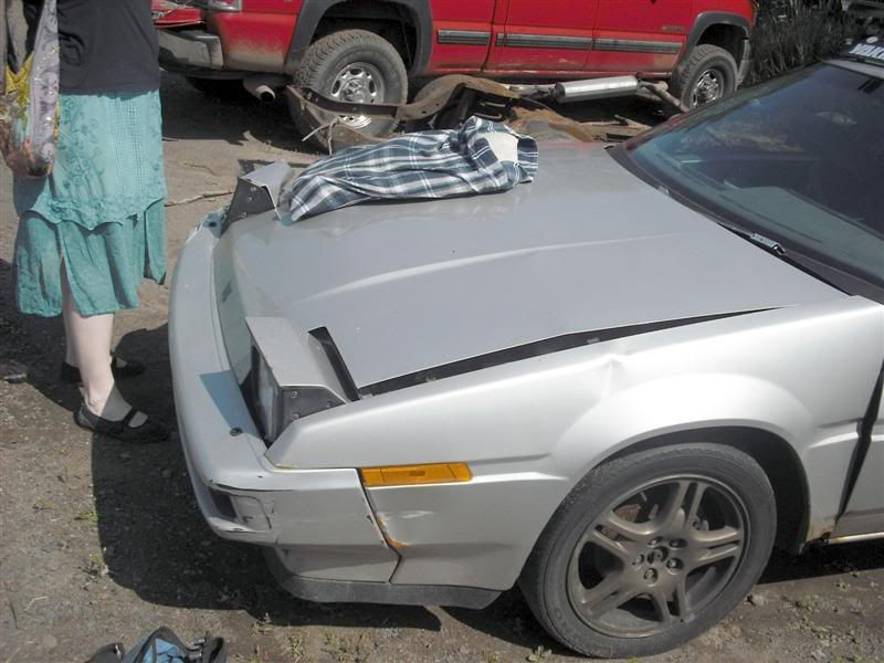

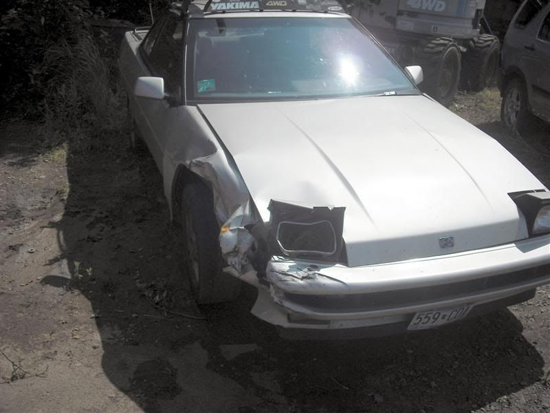

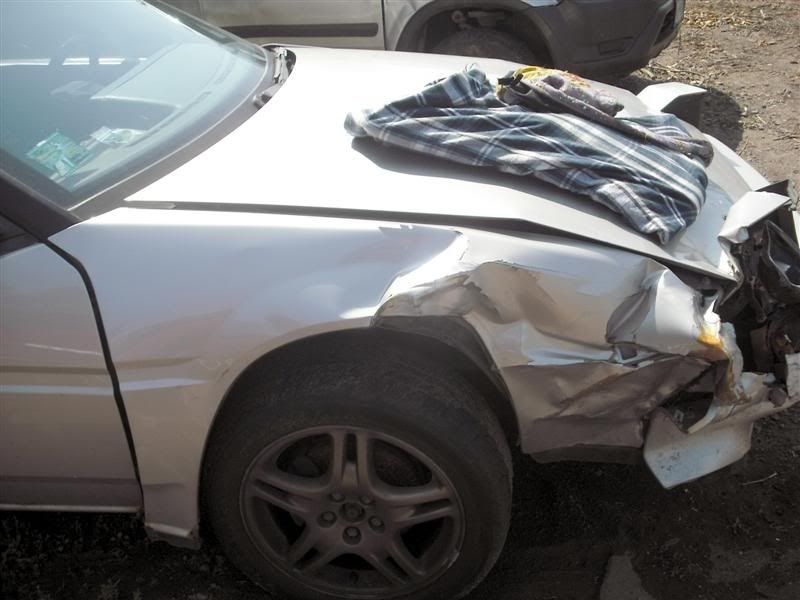

    I mentioned it in the "what did you do with your subaru today" thread.....but I actually took some pictures of it today...
    some broad made a left turn from the right lane in front of me on friday night. She was cited for unsafe change of course, so she was at fault....but yea....
    car is now at a body shop awaiting an estimate.
    pictures:

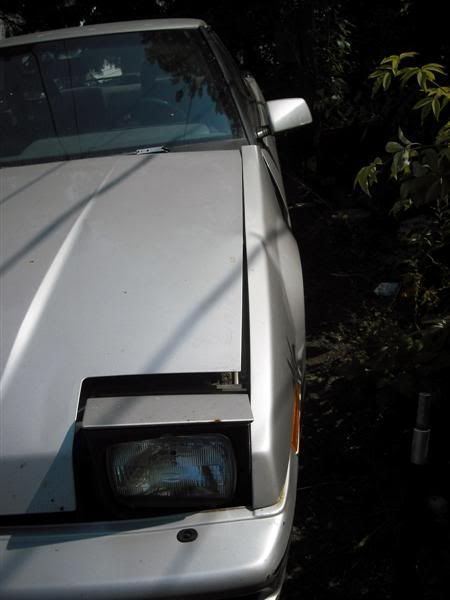

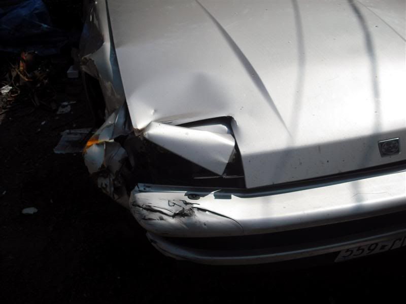

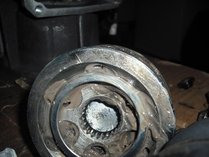

    passenger side wheel is pushed back noticeably, control arm looks mostly straight, couldn't see the leading rod. CV joint BROKE! like axle flopping around. would explain why it would roll a bit in park, but I could still drive it forward 10 ft or so out of the road. Driver's side fender is pushed back and interferes with the door :eek:
    they way the headlight is bent back, it will involve some serious prying to look in the engine bay.....so I have no idea what's going on in there.

    I'll bet its a total loss. However you could probably fix it for cheap.

    OUCH! That sucks! I am so sad to hear the the "6" got hit. It doesnt look like the side was pushed in far enough to swing a rail into the passenger side head so I bet the motor will be fine. However if the cv broke from the impact it could have sent some shock to the tranny which may not be good, but who knows.

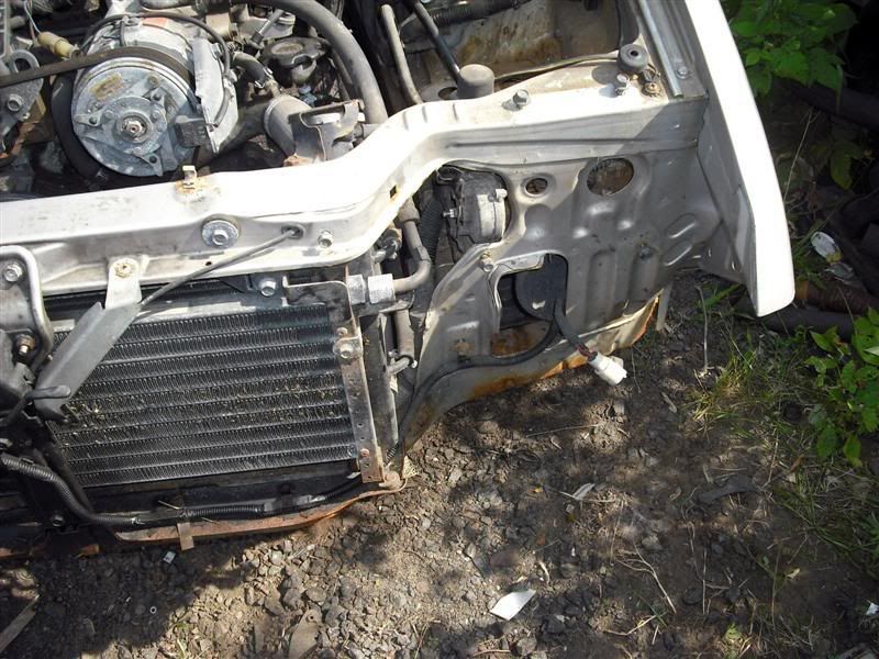

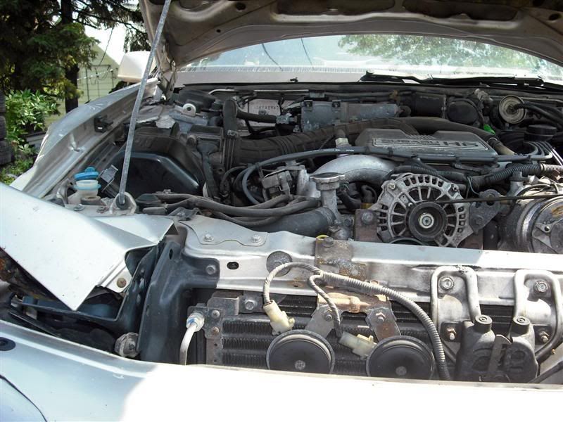

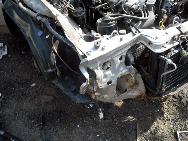

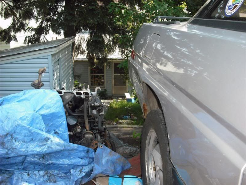

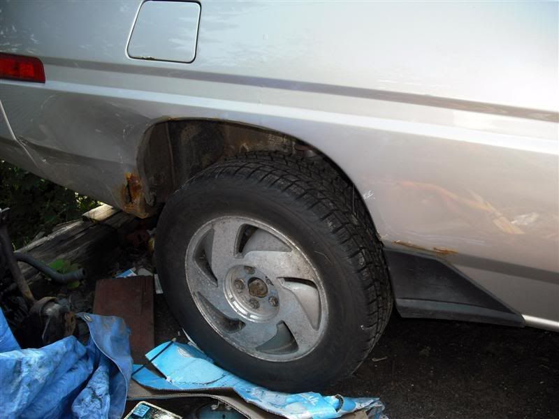

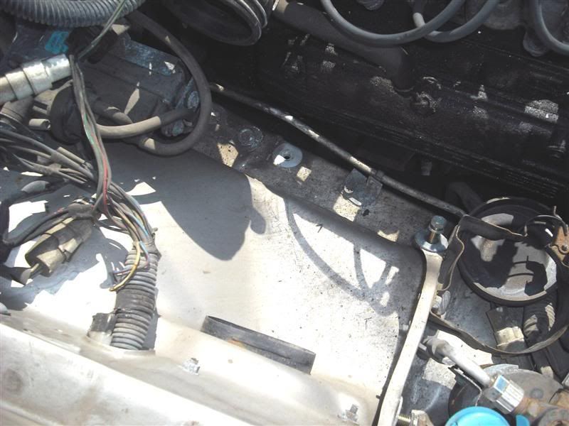

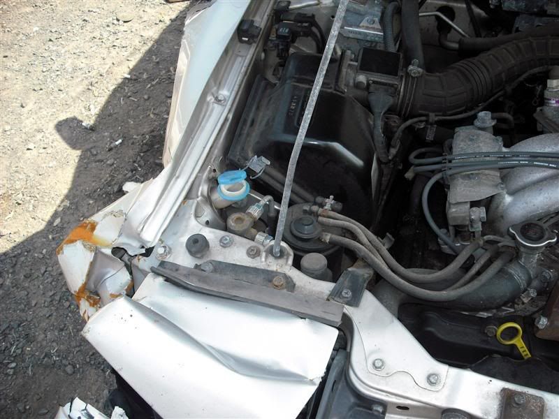

    got it home yesterday, still fighting with the insurance company, ugh. But I noticed (I don't know how I overlooked it...) some more damage on the rear quarter. the other car must have spun after the initial impact and hit the rear quarter as well.
    took the fenders, bumper, and headlights off. it looks fixable. I think I'm just going to attach a big ol' D ring to the bumper mount, and with the help of my 4runner and a chain, give it a good yank in the opposite direction from the impact.
    only noticeable damage to the frame is right under the airbox mount. there's a small kink. But the front end is definitely pushed off to the side.

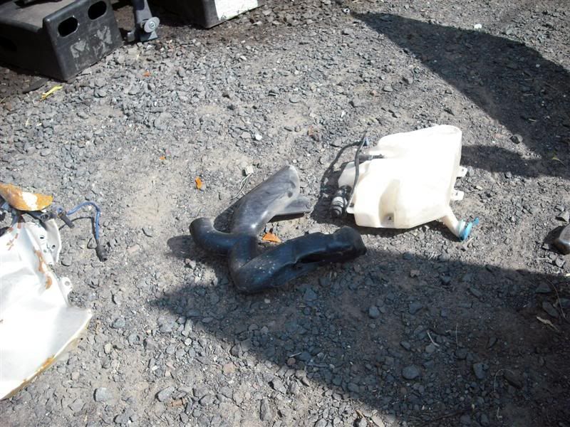

    somehow the washer tank with only minor bumps and bruises. Intake silencer.....not so much
  26. Colin
    Colin Well-Known Member
    you could probably just do what i did to micheals impreza that I just sold. cut along factory welds and replace the whole thing. there's got to be another XT in you could cut in a junk yard somewhere.
    Or: use a come-a-long instead of the 4runner + chain. much less messy.
